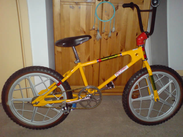

A company near me in Stafford used to powdercoat a frame and forks for £25 quid. (that was in 2007, maybe a little more now, but in that ballpark)
They did this goose for me:
Might be worth checking out the local places.
They only did the basic colours though - red, yellow, white black.  A special colour cost much more, but the standard colours, they could put my stuff through with a run of other parts.
That goose was JCB yellow.
