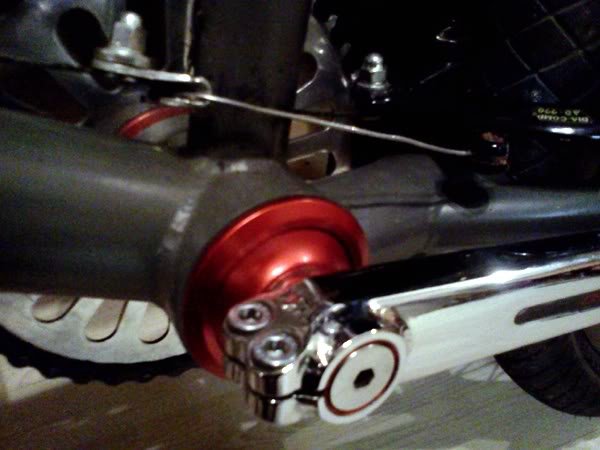

they're all pretty much the same in that price range ,  the Eastern ones are ok ,  few quid more, £23 i think,  but you can get em in different colors .
 If you can find somewhere thats still selling em,  the Diamondback packaged ones were only about £15, exactly the same as the redline set that's £30  :uglystupid2: ,  :daumenhoch:
i would recommend greasing the bearings  though before you use one of the cheaper ones , the seal comes off real easy with a small flat screw driver , the stuff thats in em is shite like a clear silicone grease , i've had a few that went "clicky" after a couple of days cos they were effectively dry, bunged in some proper guey grease push the seal back on and they been fine since  :daumenhoch:
one of the eastern ones below nice little bit of extra machining on the cups and covers

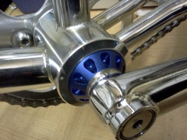

once you've got a US bb jack try to look after the large aluminium cups that fit in the frame ,  reason being is if you ever get a problem with the bearings and you need new ones you can just buy new bearings instead of a complete set , also you can go for a mid size bb which will fit the US cups,  these tend to be a bit cheaper and you can get some nicer bearing covers for the mid ones,  if that sort of thing thing floats your boat  :LolLolLolLol:
this is one of the DB ones with the black stripped off and bearing cover off a mid bb  :smitten:

Just looked at the pics Jim - the silver bearing cups in the pic with the blue covers, is that one of the DB ones? If so, is it just a paint stripper and polishing mop job bud as the black looked like a plastic-coating almost :buck2:

just cheap black stuff Spen, i think it might be a chemical colour, not as hard as anno ,   so comes off real easy    dipped em in caustic , you know how i like the old toxic fumes in the morning, literally dipped em in for about 2 seconds, but i do mix a mean caustic solution ,  :LolLolLolLol:,  then 2 mins on the bufferoo as you say , new mid covers,  job done, :daumenhoch:  the thin one on the drive side is cut the same way too   :smitten:  not that you can see much of it , just satisfies the OCD  :LolLolLolLol:

Cheers Jim, I'll give it a shot then as I've already got a set of blue covers, just they look a bit cack in the black cups, so silver would be better.
Actually, I might strip them and spray them white - just got to try and get them back into the white frame without marking them......
Nah, strip them silver I think as I'll have no chance of not knocking all the paint back off :2funny:
