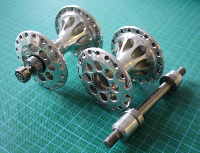

Ideas needed please
Got a very nice Rare 'low flange' hub here:
It has a Shimano freewheel on and I don't want to damage the hub 'at all'.
As its low flange - I cannot re-lace it with the freewheel on.
Any ideas welcome, before I go to work on it

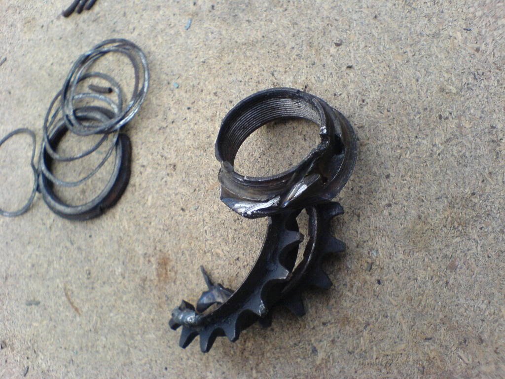

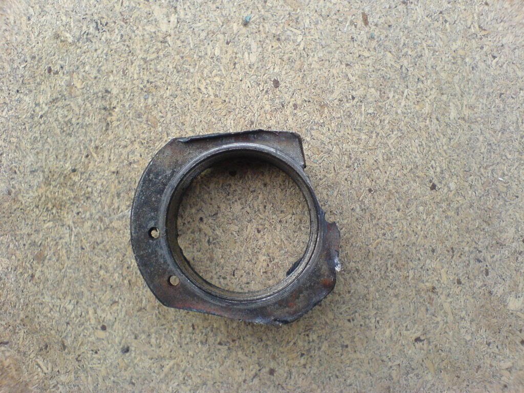

There's a pic on here where someone has done it.
http://bmxmuseum.com/forums/post.php'tid=159490&qid=1373757
I took this freewheel off recently it give you an idea what it looks like apart in case you want to take off the cog so you can lace up both sides.

Offline diesel
  • Posts: 1594
Re: IDEAS NEEDED - How to take a freewheel off from a hub?
« Reply #16 on: December 07, 2011, 09:35 AM »
Ive got a Mig here if you want to weld it up Dan :)
Cheers Justin, will keep that in mind  :daumenhoch:
Offline diesel
  • Posts: 1594
« Reply #17 on: December 07, 2011, 09:18 PM »
Right then all laced up, freewheel removal tool fitted, ready to take to work tomorrow so that I can used the bench.
