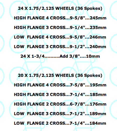

What length spokes do I need for bullseye hubs to 24" rims  ???
240 mm  ???

Here ya go Carl ... Seans new guide http://www.radbmx.co.uk/forum/index.php'topic=136816.0    ....... just don't do it after an afternoon in the Bowling green  :D

I've just laced some low flange hubs to 24" 7x with a 3 cross using 240's and they are a bit too long  :-\

So it looks like i need
Ill fook that up somehow Joff ..  :-[
 So i should be safe with 238mm  :-\
