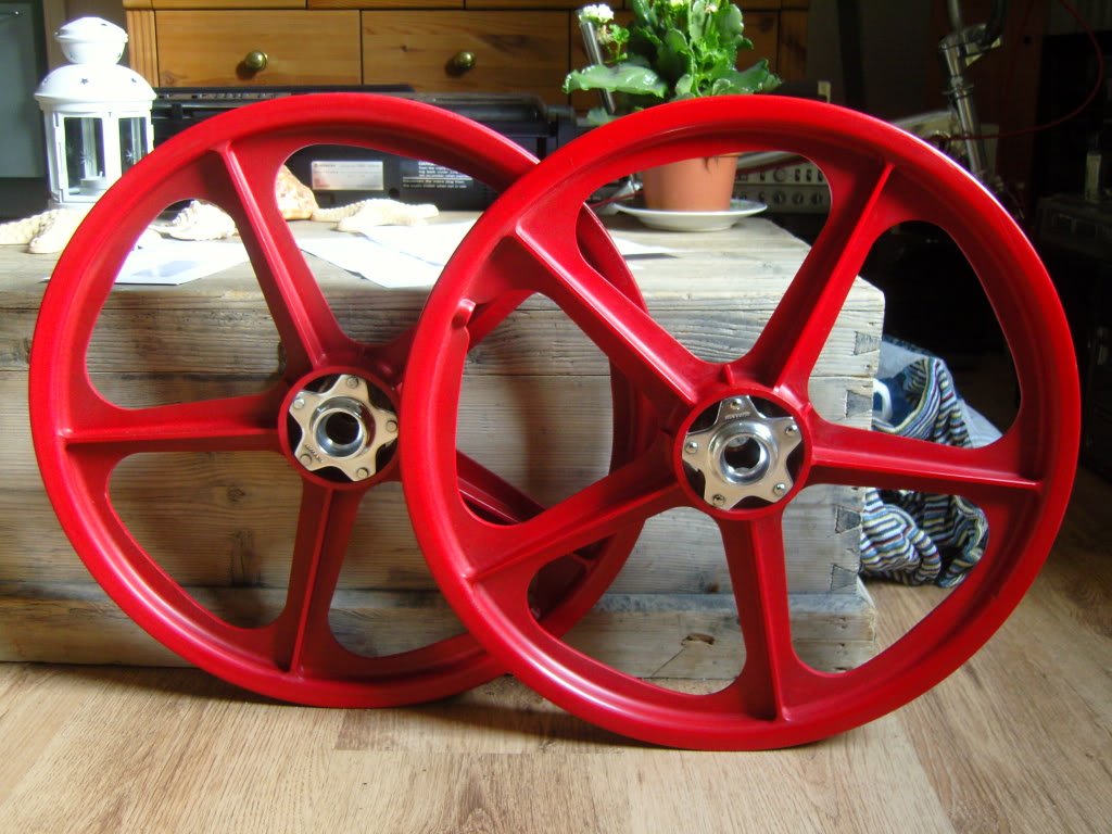

Hi People. Just a warning: this resto isnt for the faint hearted :)
Got these a few months back from  oldskooldayz and were paintec red with two pac automotive paint. The pair of them looked like this:
Verry glossy finish on both and had no chips or anything.
I was assured that they were originaly red, so bought them and thought it would be a piece of cake to strip and restore. ( I haven't come accross two pac paint before :-[)
First thing I did when they arrived, was to try a very soft approach to stripping the paint. I tried nail varnish remover, then very fine wet and dry paper, then dot 4 brake fluid, then a razor blade all with no joy whatsoever :(
I then thought I would try Nitromorse as it was the only thing left I hadn't tried and also I thought that before the stuff could do any damage to the mags, it would have to get through the paint first. So here is the next step.
I kept checking the wheel every five minuets, just to make sure nothing bad was going to happen, but bugger me after an hour nothing was happening to the paint :(
I then put more notromorse on and left for another two hours and this is what happened:
the paint was just starting to lift in a few places.....at last
