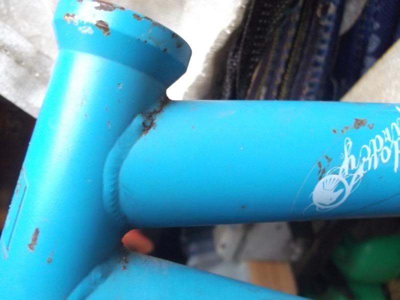

alright guys, bought a new school mutiny cosmotron from the local friday ad, turns out the frames cracked at the headtube, little pissed but it was very cheap so cant complain
just wondering if anyone here is any good at welding? crack is around 1/2 way round the downtube weld
cheers in advance

Cracked weld doesn't sound too healthy that. Even if you do remove the damaged weld and put another run around the head tube then it would need to be heat treated afterwards if the frame is 4130 to get the strength back into the tubing as the heat from welding would have affected it. This would be especially critical at the head tube with the high stresses it will receive.
+1
If you intend to use it in anger i would be very wary. I would only use it for cruising round on unless you can increase the surface area of the weld with a larger version of the plates they put on the downtubes these days. May not be pretty though :'(

What material is this frame ? Got any piccys u can stick up ?
its 4130, heres a few pics

You can weld 4130 with a mild steel filler rod with Tig so any general fabricator who is half decent at Tig could repair it but as I mentioned it would need heat treatment afterwards to bring back the strength to the heat affected area if you wanted to ride the bike for its intended purpose.
ah isee, its only going to be used as a pub bike anyway not going to be jumping with it

Just pop in your local fabricators with it and ask if they are set up for mild steel and can they weld it up for you.

That weld is fookin shite no wonder it has cracked . Welds should never break  ;) the parent metal should break first  :shocked: Pm me if u want bud  :daumenhoch:
