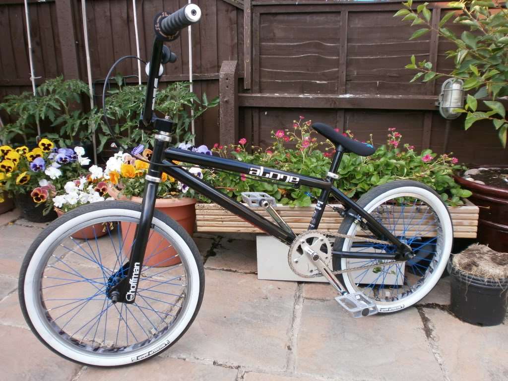

a 75mm post will be run slammed, or as close, you always want 50-60mm of insertion depth, the more post showing, the more you want inserted, ooer!!!
I have a deluxe combo seat on my Alone with about 3 1/2 " of post showing, leaving 2 1/2 in the pipe. Its a good height, not too high to get purple bruises up your thighs, not too slammed so if you sit down you can't get back up, and low enough to not get laughed at by the kids!!
My first piv was over a foot long, I cut it down to 7"

This is the best pic I have on photobucket, and I can't be arsed to go in the lounge and take a new photo!!
Its not pivotal, but its what 3 1/2 inch of shaft looks like!!!
