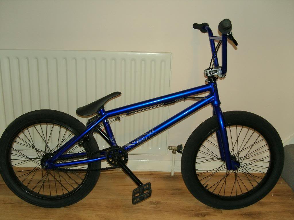

Well i got the Stereo today and love the colour
started putting it together and started to adjust bars straight and line up with tire and do bolt up
 ???  top hat bolt is just going round and round ? so i take the bolt and look to see why
the bolt has the inside of the fork head bit (don't know what there called) and can see that the star washer has popped the part out that is on the bolt and now has a crack in it ? wtf
so what's the score with this - FOOKED or repairable ?
if i was a little 5 yr old i would be crying now  :'(
the chain looks a bit loose and don't know if it need a link out - and brake needs dialing in
grips have a funny smell like fox shite - will be having a word with Jim about this  :knuppel2:  ;D unless he didn't know
so please let me hear what you think about the forks ?
holding back the tears ~ B

Just hammer out the star-fangled washer from under the forks using a metal rod/ wooden spoon handle, pop down your LBS and grab a new SF washer for a quid :)

Mate its a simple repair... use a screw driver and prize the rest of the star fangled bolt out.  go buy a new one... (or i have a spare if you want i can send on....)
easy enough to fit if you have the right tool - take the forks along to your LBS and they can do it for you in under a minute...
DONT PANIC - it aint fooked!

as said above  :daumenhoch:   or if you don't want to get it out, just hammer it further down  :daumenhoch:

Yup, nothing too bad, just need a new star nut  :daumenhoch:
When you put a new one in, make sure it sits nice and straight in the fork, if its off it won't sit nice and snug when you tighten it all up together.
This time just tighten the stem on the forks to just above finger tight... then tighten the top down until there's no play, but not too tight (its only there to help, dosen't have to be gorilla tight  ;D)... then tighten the stem up... so that its all snug together  :daumenhoch:

easier to get out than in-like above these must go in straight -i think you can get a special tool to help them go in properly but also like above probably just as easy to take to local bike shop  :daumenhoch:

The chain looks like a half link bendy so just take a link out. As said by everyone just fish out the old star nut. There are several ways to do this. either tap it down and leave it then fit another on top. Or use a junior hacksaw blade and a drill to cut/drill through a couple of the fins. They are made to only go in the forks one way which is down. So if you want it our this is the best option. Should be pretty easy. Only 10 minutes work for a builder of your stature!  :daumenhoch:

took less than two minutes to take out and put in  :daumenhoch:
but it wasn't me doing it  ;D  went to Evan's in Guildford - and as there a new shop they have some staff there the know how to work a bike - the guy had the right tall to just put the star in and bang down - job done
do find some of there staff a bit off'ish if you not asking about MTB's
used the same top hat and bolt - in all saved me messing about and next time i will know what not to do and how to solve it

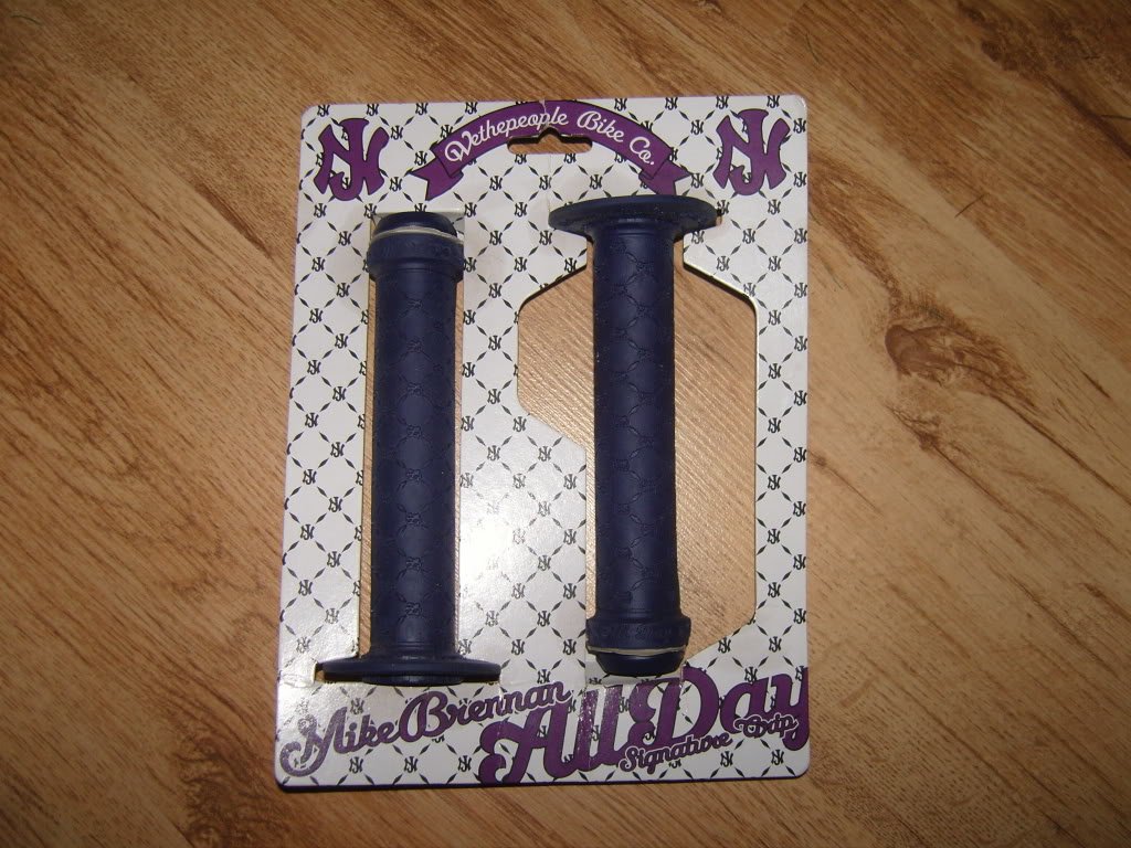

Macneil traveler grips ~ black - flat face with light chequer pattern - grippy but thinner
WTP - Mike brennan All day grips ~ blue/purple - flat with NJ cross inprint - grippy and slight thicker than above
the original Stereo Jack plug grips - show signs of wear but have a grippy softer feel - i like them and they don't smell know after a wash
so which to go for ? - the macneils look good - the stereo are soft but might want to try some thing else - WTP look different in there colour

I'd give them wtp grips a whirl mate. Are you leaving the seat slammed?  I couldn't leave it like that if it was me.  :daumenhoch:

Been running those WTP grips for a while now, Fooking love em!!  :daumenhoch:

Rob how are they on the hands ? the macneils feel thin and not slipped a WTP on yet - how do they wear - had some old grips that just started to get sticky !
