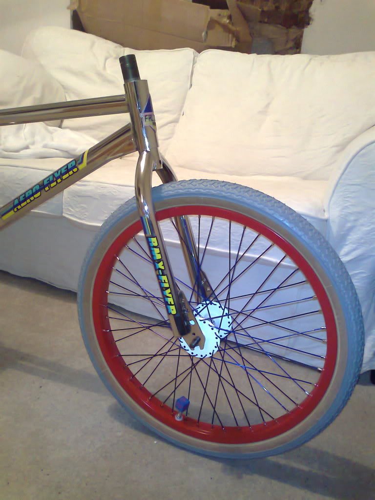

Re: Sun Mistral Rims and GT Hubs Restoration **UPDATED**
« Reply #17 on: February 28, 2012, 12:39 AM »
Here are some shots (again, not great) with the wheels loose fitted to the frame.
I think the tyres look a lot better when they're with the chrome frame.
I'll take some more pics when I get the black with white wall tyres.  :daumenhoch:
