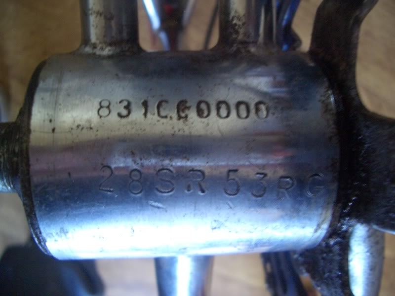

KuwaDaz
Re: Frame n forks identification please
« Reply #4 on: March 07, 2012, 09:48 PM »
Oops forgot to add the bottom bracket pic, here goes. Ignore the post code i've already knocked on the door as its close to where I live, and the occupants don't know anything about it lol....
Offline Taipan
  • Posts: 3674
« Reply #5 on: March 07, 2012, 10:18 PM »
Thats no kuwie,looks more like a generic copy style f+f set,I doubt the forks are Tange either,see if the forks are stamped under the threads?
Offline bodamus
  • Posts: 2095
« Reply #6 on: March 07, 2012, 10:26 PM »
Yep not a Kuwahara or Tange made Frameset I'm affraid could be a copy like Akisu or something similar.
monkian
« Reply #7 on: March 07, 2012, 10:31 PM »
I think the forks might be Akisu ???
I don't think the end caps, the hole in the blades or the weld over the base of the stem tube are Tange style.
The frame looks nicely welded mind but no idea who made it.
« Reply #8 on: March 07, 2012, 10:51 PM »
JEN MING AND AKISU BLADED FORKS
'83
round top tube and tear drop bottom tube
does it have Cr-Mo on the rear drop out (some did and some didn't )
fork have the same tear drop as the bottom tube on the frame - never looked great at the front when welded
seat post might have Cr- Mo on it as well
bars not sure
sold as frame and fork and then bits added to make up a complete by shops
cheers B  ;)
