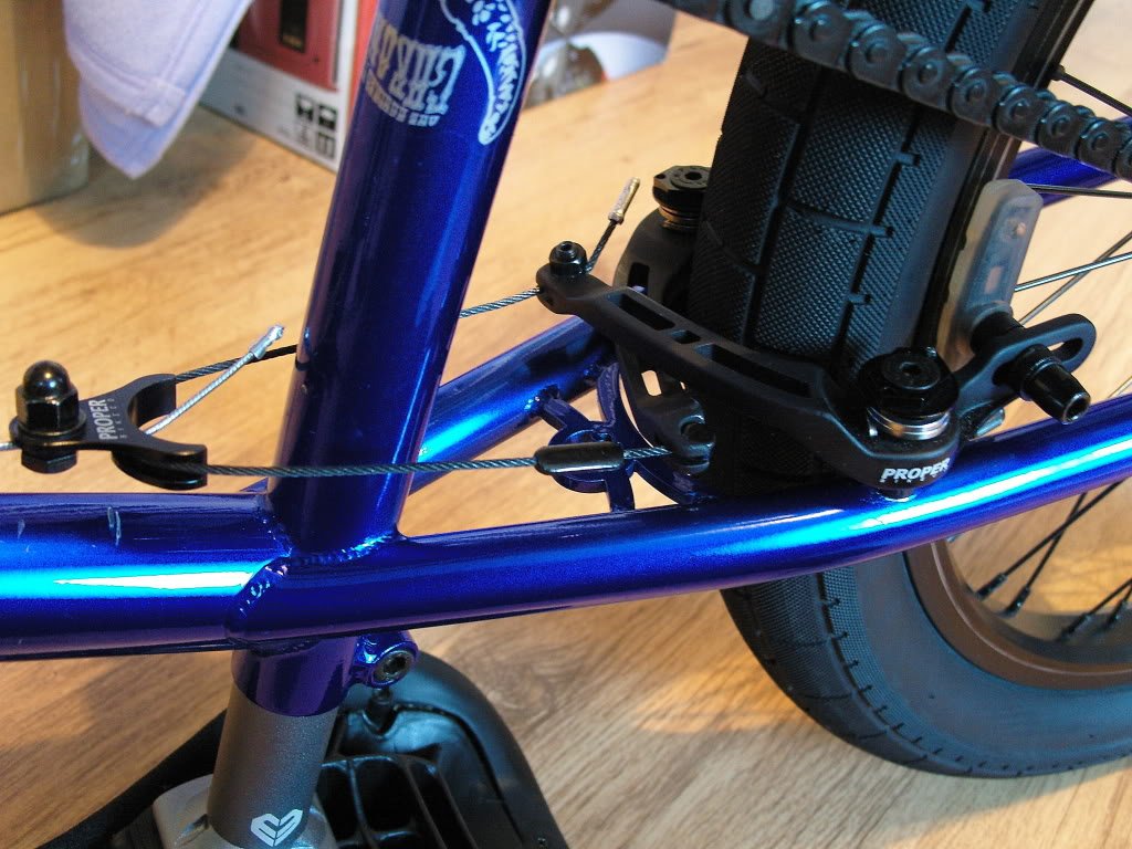

Right the fly brake was a pain in the butt - just wouldn't lock on and spring back
so plan B.E.  have to be put in effect
a new set up of Proper calipers set - hooked up to a united cable and then on to a Colony lever
stops like porsche brakes now - sweet  >:D
