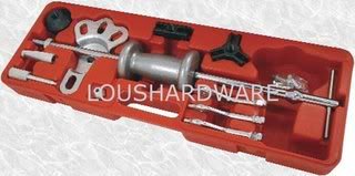

You need to get a big slide hammer,
Drill and tap the end of the bar,screw a bolt in there,and attach it to the slide hammer :daumenhoch:
get someone to hold the frame and get hammering :daumenhoch:
looks like this
