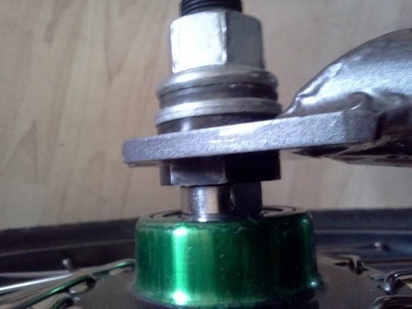

if the slots in the dropouts are 14mm they should fit straight in will be a snug fit but nothing that kneeds a hammer,
have seen some frames and wheel sets that used a 12mm axle , on mid school bikes,   mostly on the front but may have been on the rear , i assume you have measured the slots , posting up some pics might help?
the set in my pic are on 14mm rear dropouts but have used em on forks with 14mm slots ,  some i had to spread out the forks sideways,  but only about 1mm easy done by hand .

« Reply #18 on: March 27, 2012, 07:48 PM »
Got them to fit, but had to file 2 flats on each bolt to get them in there! One side of both of the drop outs was less than 14mm, weird.

« Reply #20 on: March 28, 2012, 09:03 AM »
One side each of the dropouts if viewed from the bottom had an angle on them, so if you inserted the adaptor from one end it went halfway in, from the other it wouldn't go in at all. Anyway, I'm happy with how it is now, seems nice and strong.
