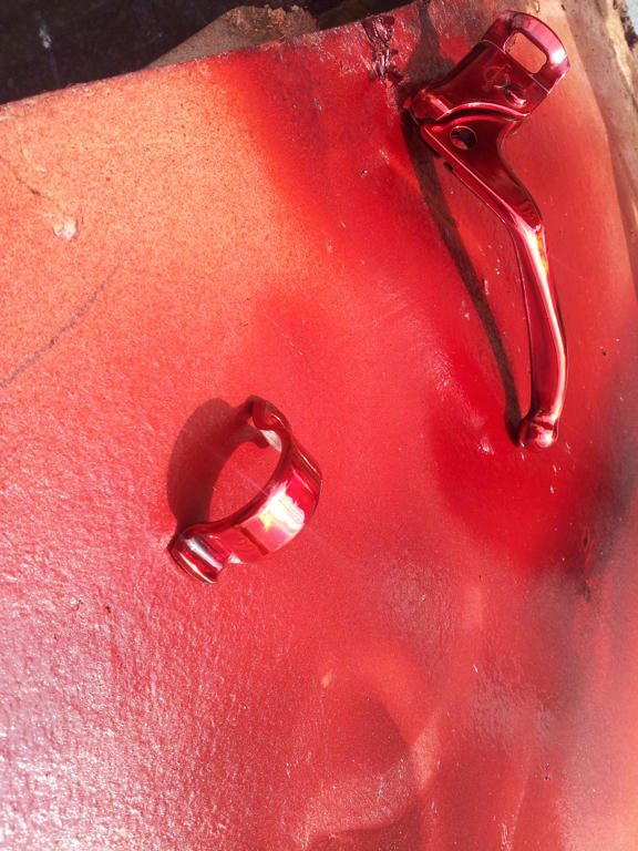

so finally received the annodize spray ive been waiting for

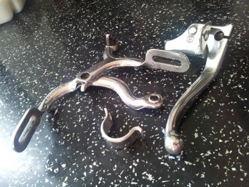

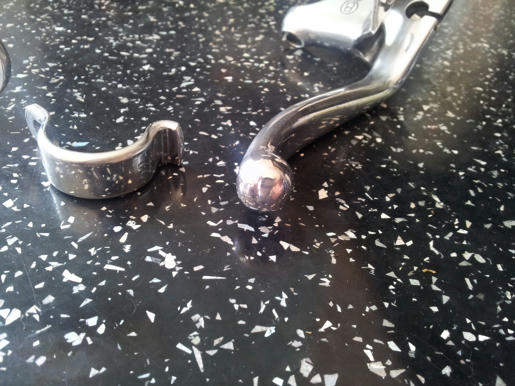

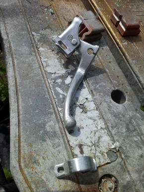

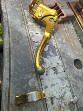

so here go,s diacompe bent lever of sawsal thanks fella..stripped gold anno of with oven brite then flatted down with 400 grade paper then 1000 grade then 3500 wet pad then straight onto polish wheel

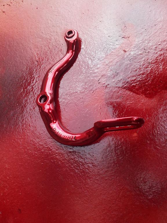

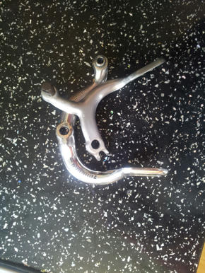

then received shimano tourney front brake of rollin72 cheers fella..brake was down to alloy already so wet n dryed with 1000 grade then 3500 wet pad then on to polish wheel for light polish.
then get ready for it METALCAST DUPLI COLOR ANNO SPRAY..2X LIGHT COATS TO LOOK LIKE THIS

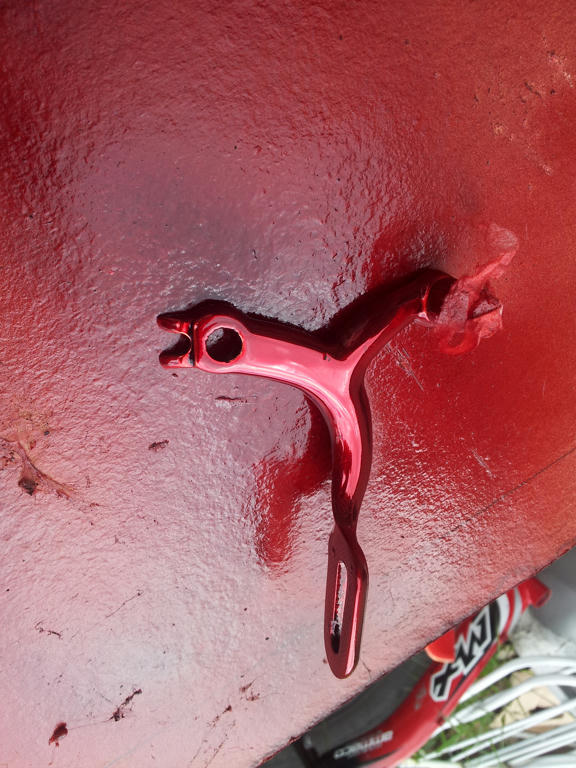

More pics to follow,as ive now gotta do seatclamp and rear brake to make minty like the front lol

gotta wait 12 hrs then i will be able to tell..im not to sure if im meant to laquer them or not..but look good so far

finished of my brake resto..the metalcast paint seems to work better on a wirewool finish..it does scrape of if you scratch with something..so done a few laquer tests and found that halfords own brand laquer works the best with metalcast anno spray..the finish is excellent im well happy
