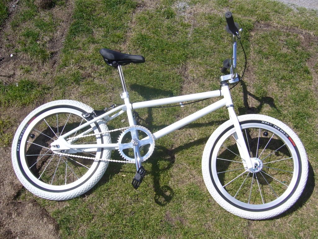

16 spokes On my GT  :daumenhoch:

Who makes them wheels   ???

Peregrine MAD MAX  >:D

Some bang tidy mid school rimmage  :smitten:
