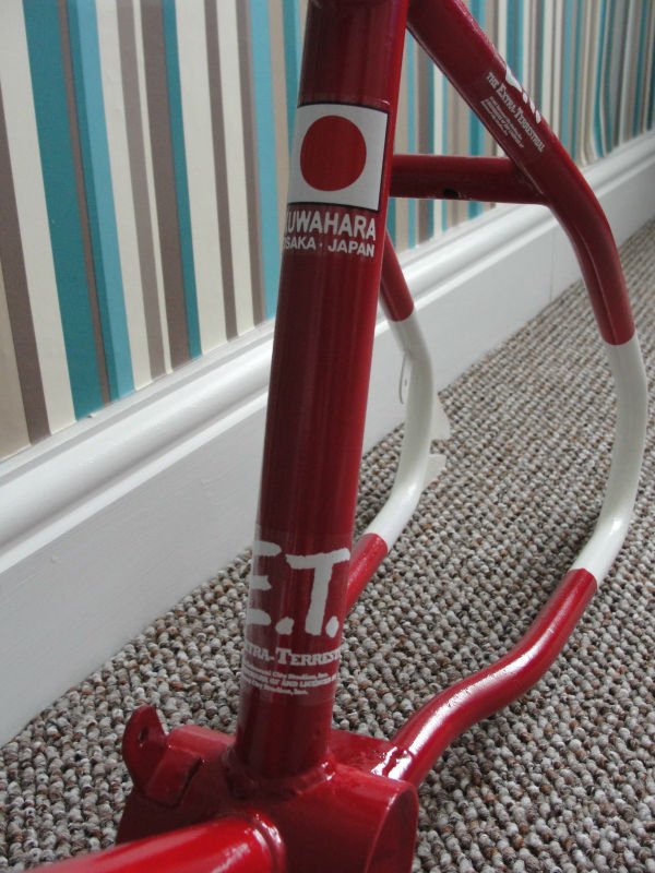

Well ive had this bike in the shed for a couple of months now and didnt know which way I was going to go with it?  I ummed and arred for a while before deciding to make a cheeky little Kuwahara E.T Rep for a bit of fun :)
I stripped it all apart, standard stuff really....until I came to the crappy KK stem that seemed to be seized solid in the forks!  Me and the mrs played tug of war with it for a while but that wasnt working so I ended up having to smack it out from underneath for the best part of 20 minutes.
I used Peugeot diablo red as i could find any Lucifer red anywhere, standard white and then clear lacquer.  The decals were off our friend Del....Im really impressed with it as a look a like....The finish is awesome considering its rattle canned.
This is how it looked when I first got it:
And with a whip of the magic wand...It ended up looking like this :)

Thanks bud :) .....Halfords paint of all things lol.  I never ever praise "Halfrauds" because of their prices but it seems their paint is pretty good!  No sanding in between stages and a good dose of clear coat works wonders eh :)

Once I'd eventually got the stem out of the forks, I set about the prep.....so with degreasing everything, flatting it all back....wiping it down, letting it dry, primer, paint and lacquer it took me about 3 or 4 hours i guess.  i left it until the following day to apply the decals.....thats when it really made a difference!! :)

Yeah this was just a real cheapy :) .....Truth be told I paid a tenner for the whole bike lol.  Then i spent the best part of £40 on paint and decals lol.  Was well worth it though :)
