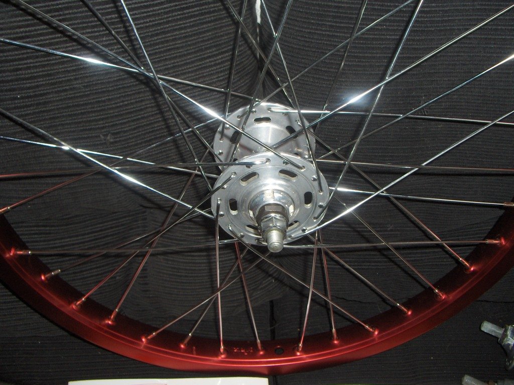

Here are some picures for you....
Radial (0 cross)
2 cross
3 cross
4 cross
Here is a back wheel laced 1/2 radial (radial on the non-drive side and 3 cross on the drive side), oh what fun that one was to calculate spoke sizes and to lace.
Offline Andy68
  • Posts: 2378
Re: 3 or 4 ply laced wheels, what are the differences...
« Reply #7 on: October 29, 2012, 01:13 PM »
Sexy wheels Sean!!!  :smitten:
