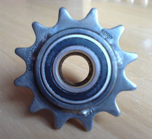

PROBLEM SOLVED!
Was speaking to my dad at a BBQ on sunday night and mentioned this driver issue and asked if he fancied having a go at popping out the central bearing, cutting off the existing 14t sprocket bit, and then welding on a 12t Kore coaster sprocket I had sitting here.
So I got home this evening and this was sitting in a flowerpot at the front door...
The driver has even got 3 "register" grooves machined into it now to set the sprocket before it was welded, so even if the weld cracks (which I doubt!) it'll still bite enough to stop me flipping over the bars, as with a chain breakage.
Cheers Dad!
