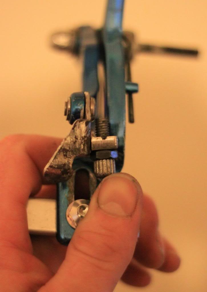

just leave the quick release on, put an adjuster through the hole and you can still use the quick release.
Offline GavinDavis
  • Posts: 4590
How do you mean John?  You got any pics as im trying to work it out in my head  ???
Offline john4130
  • Posts: 1589
like this.
Offline GavinDavis
  • Posts: 4590
Aha!!!  Good stuff John  :daumenhoch: ....I think i was having a bit of a blonde moment at the time  ;D
