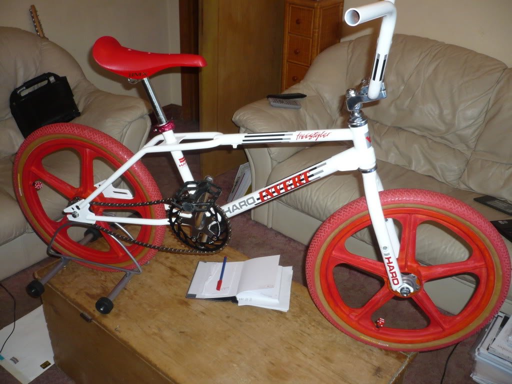

Not done anything this week, but Del called round at my house with some custom decals that he made for me. They are proper good, I almost didn't want to take them off the backing sheet. I got my lass to fit them for me, she's got steady hands and an eye for detail.
last pic I have put on a new chain and some red dice caps

She was too, took some advice from Del and we got a plastic garden spray, with a mix of water and washing up liquid. Spray a light layer on the bike, then the decal can be moved or took off without any damage.

Yeah just push any air bubbles out and its sorted. I wouldnt go out straight away riding, maybe one might move if you knocked it. I guess its best to leave it overnight though, to properly stick.

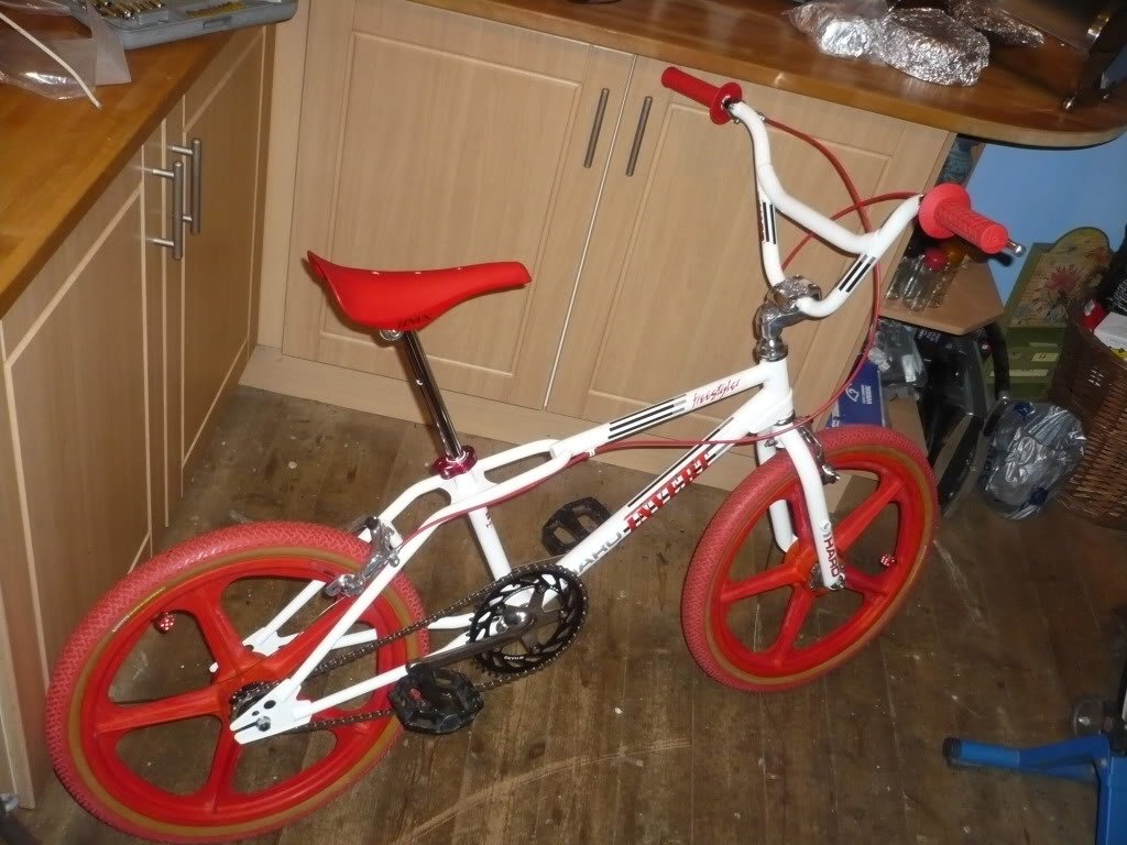

Finshed it tonight, just got to cut off the excess inner cables. Its turned out great.

Looks Tidy!Del has done a great job and props to the missus too! :daumenhoch:

Looks cool does that  :daumenhoch:
I'd cable tie that rear cable up and run the front through the stem bolt but all's good  :daumenhoch:

Pickle, I still need to tidy the cables, but I might well end up with a gyro and then run the cable through the hollow bolt for the front with a backwards potts brake, but that will be next month.
Only 2 things I dont like are the pedals, which were some spare cheap ones, and the red seat clamp, its the wrong shade of red compared with the other parts, I might get a plain silver one to match the stem.
