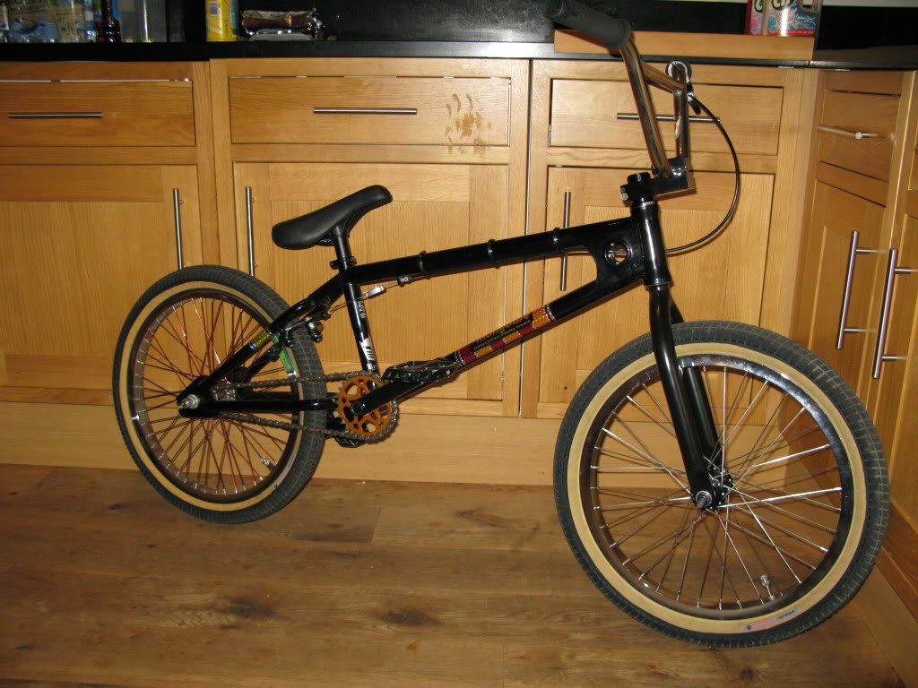

Here you go Nick, I just sprayed a blue and a silver one both black for my RetroGeese builds :daumenhoch:

« Reply #5 on: February 13, 2013, 11:46 AM »
What kind of paint Spen. Anything in particular ?
What's plasticoat ?
"WWG1WGA"
Re: Powdercoat on Suntour stem
« Reply #6 on: February 13, 2013, 12:23 PM »
Nothing special Nick. I think plasticore is just a paint manufacturer but could be wrong. Got my tins from the local car spares shop down the road.
Just use a decent primer and plenty of layers of thin top coat. I also put my paint and item i'm spraying in boiling water for a bit then if the Sunday roast isn't in, chuck them in the oven on low (about 150 degrees) once they've set. Usually tough enough after two or three top coats but keep it thin and smooth spraying. Also change which way you hang the item so you don't get wet runs in the same spot.
Spen, what happened to the double clamp stem?
That was probably my favourite bit...
« Reply #14 on: February 14, 2013, 06:20 AM »
I know Griff but it was for 1" diameter bars and I couldn't find a decent set..... Discussed having these modified by Animal but went with the standard option to make sure I couldnride it at Wini's do....
