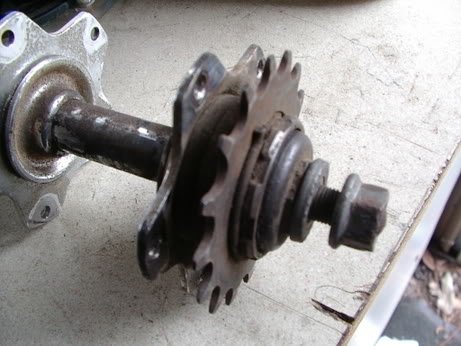

They are like this bro  :daumenhoch:
I don't think this is right , any chance of a picture of inside the wheel hub area. It doesn't look like the hub is big enough to hold the coaster innards. The pictures are of a ACS free coaster modification. If you look at your hub where the sprocket goes on it has 6 or 7 splines. A coaster will typically have 3. Take care with knocking things about.  I can't find mine unfortunately. With a picture of inside the hub i t might tell us a bit more

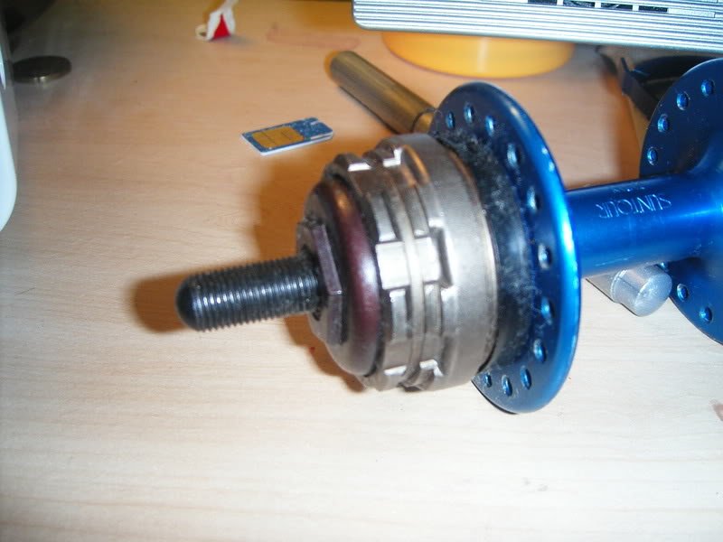

Sun tour hub picture

that looks similar, but I still cant figure out how to get mine apart

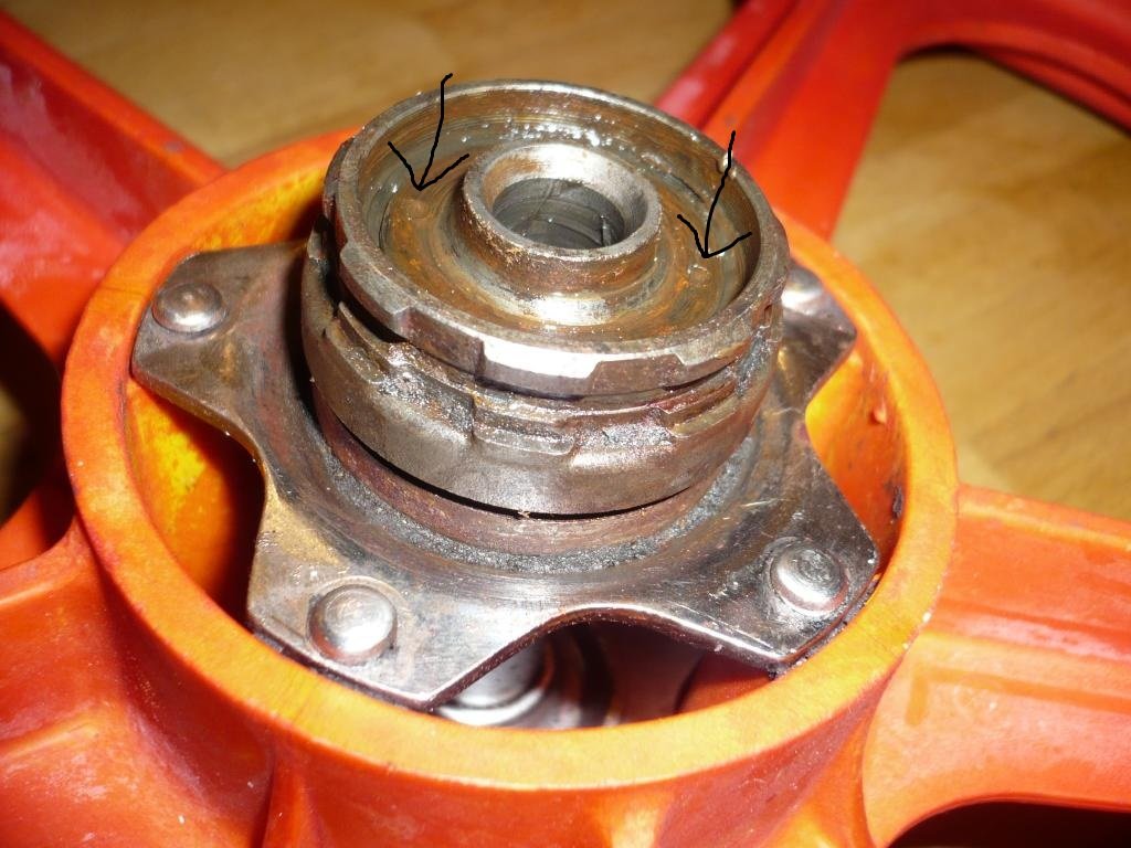

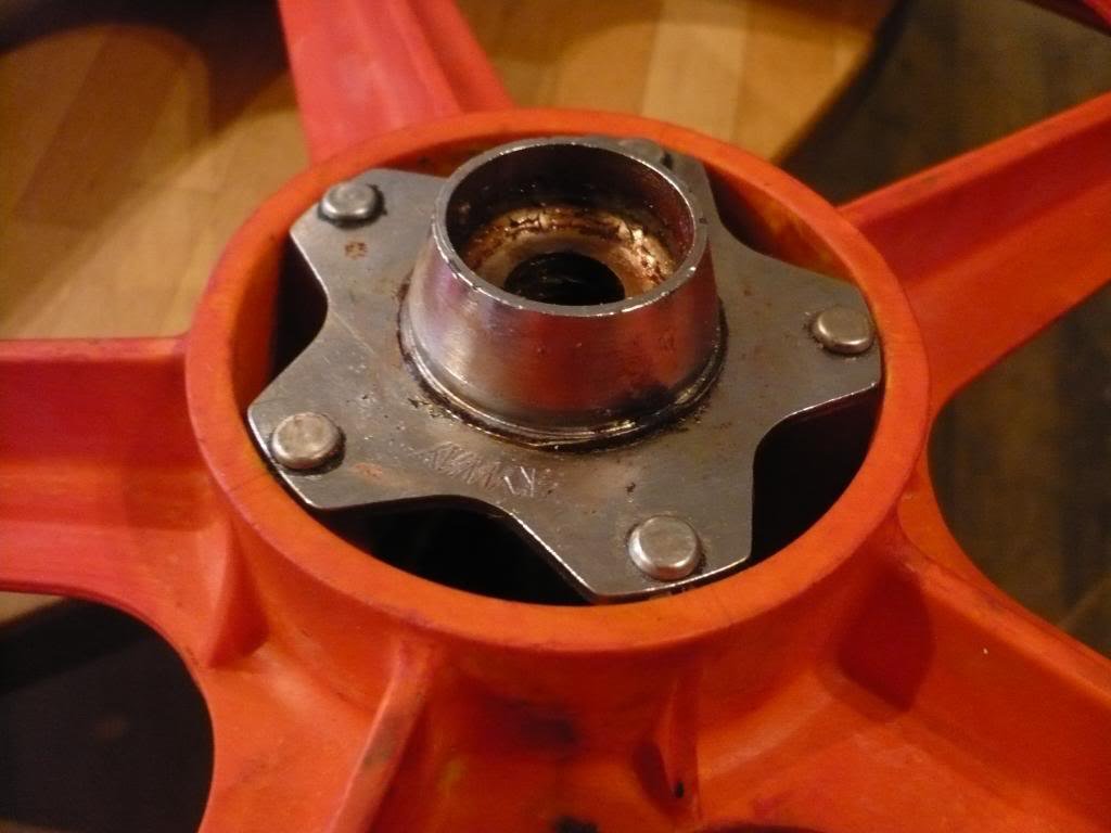

I removed the axle, mine came out similar to the front wheel. Slid out the axle and nothing else moved. Here is the non sprocket side. The bearings sit in this area. This "cup" appears to be pressed into the star shaped hub. There's no way its moving or coming out.
Next the sprocket side, above the sprocket, yours has 3 notches I think (cant see the rear), mine has 8.
Circlip removed and the sprocket lines up with the notches and slides out.
This is what I am left with. There are 2 small hole marks. This looks like if its turned, it should come off, there are tiny bearings under it. I cant tried turning it left and right and it will not move. I don't know if its a normal thread of left hand thread but either way it will not move at all. Even if this bearing cover did come off I am not sure how I can remove the outer hub.

Thanks Stu, so it is as someone mentioned, a left hand thread. So if I can get that to come off the whole thing should come apart. Its going to take some moving though, its been on there over 30 years by the looks of it.

I held a lighter on the locking ring for ages to get some heat into the ring, and it drifted out no problem.
This is whats left on the hub. I am pretty sure this last bit is pressed into the 5 star hub bit.
These are the parts that have came off when it came undone.
And this is what is playing up, two little tabs that must close when freewheeling and open up to lock the freewheel.
I can't see anything thats an obvious cause of failure, I am thinking possibly the little tabs are not opening out because they are caked in thick dirty grease.
I am going to reassemble it tomorrow, I will grease up the bearings tomorrow. Can anyone tell me what kind of grease or oil I should be using on the tabs?

 :) The 2 little tabs are called pawls.Use a very light oil and you should be fine.
