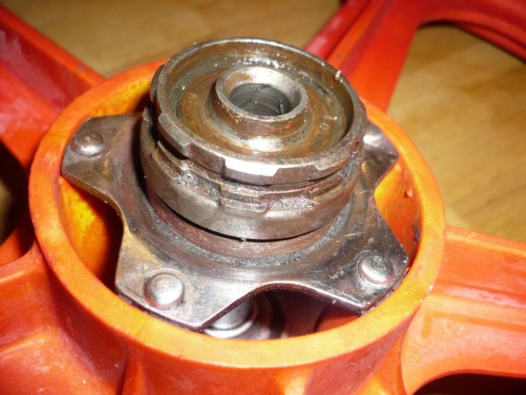

I rode my new build today, for all of 5 meters, and my chain started spinning the rear chainwheel around but I got no drive to the rear wheel. I took the rear whee to a local cycle shop and asked for a new freewheel. 5 minutes later they came back and said, it does not have a freewheel its a cassette type, and he mentioned the parts to repair it have probaby never been available since the wheels were made.
Does anyone know if its possible for a repair on this, or should I look for a new pair of wheels?

I will see if I can get that clip off and take a look. The fault is intermittant, it will ride for a few meters, then slip, then work, then slip.

I have took a few pictures to show the rear wheel hub. Heres a pic so the type can been seen.
I have managed to remove the big circlip and remove the rear sprocket.
This last pic shows the hub with the sprocket removed. If I spin the top part of the hub while pushing down into the wheel, it locks solid as it would when working correctly. If I spin it while pulling it away from the wheel it slips and jumps, this is whats happening when its being ridden. How do I strip the hub past this point? I can't see any thing else that screws or and more clips to remove. I tried to gently prise it off the wheel but it seems to be held in place, I don't want to try prising any harder unless this is the correct way to remove it.

i'm not familiar with that hub but it looks like a coaster to me, have you tried unscrewing it? see if it turns anti-clockwise to remove the drive and clutch.

Spinning anti clockwise is doing the same as when the bike freewheels, it just goes round forever clicking.

That's a cassette drive hub bro. Put a pic up of the other side of the hub. I'm not sure how these are put together but some are pressed in place over the bearings and ratchets, some feed though the hub centre and are secured on the opposite side  :daumenhoch:

This is the other side, I have tried turning it with a wrench and tried pulling it outwards with pliers, seems to be locked in somehow very tightly

Try not to turn the reverse side buddy, it will not move. Your cassette drive is pressed on I think. There are 2 small holes I see on the pic of the cassette hub, grease holes. I'm not sure but yo may be able to release the cassette like a car stereo with those holes. Use 2 centre punches in the holes and move it round slowly. It might release the cassette.

Actually, thinking on it, I think you need a special tool that mounts in those holes and you turn it clockwise while holding the cassette. It looks like an ACS freecoaster bolt when it comes out  :)

Right I am with you, these are not holes that go right through when looked at close up, they are just 2 sort of half drilled holes, looks like it would need a tool to move it, similar to some freewheels, I will try and drift it round.
