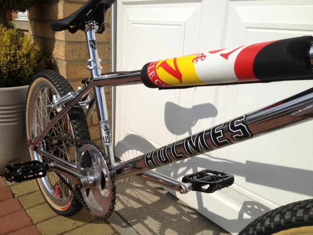

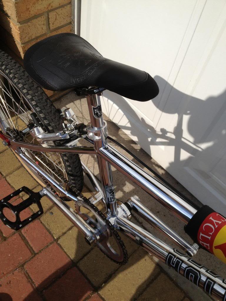

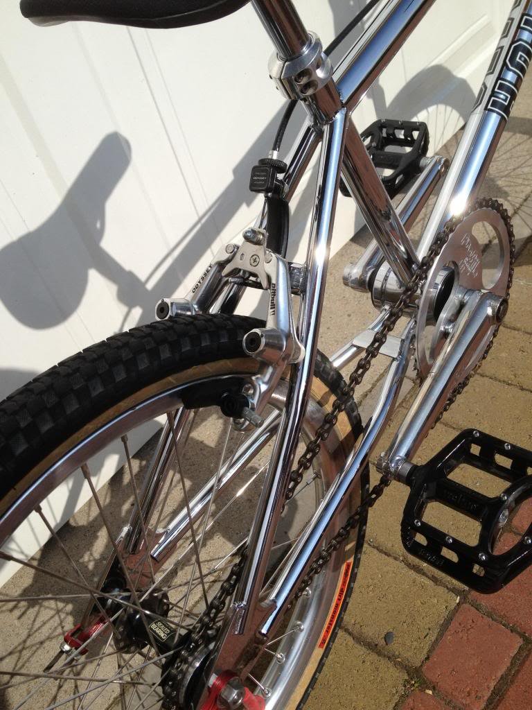

Looks ace Anth  :daumenhoch:
Nose of the seat up a bit though  :daumenhoch:
The post's in the post  ;)
2 minutes turkish...
LENNY-LENTINI
Re: My new bit on the side - Dont tell the wife!!
« Reply #76 on: May 26, 2013, 12:36 PM »
Brother that bike looks fckn mint.
Gotta change the angle of the seat tho'.
Position it like a concorde coming into land then the bike will be proper MidSchool.
Good work
Keep the Faith.L

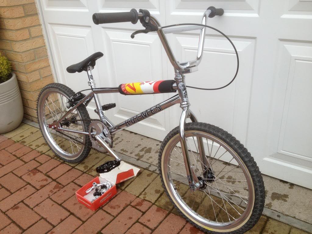

I'd change the seat for something more era correct, apart from that it's sweet  :4_17_5:
Still want it  :smitten:

I've got a oddy svelte, tried it on but it just looked huge.
I've got a nos pitbull 2 but I would need to cut the cable to fit it, at the min my brake is not good but not bad either so might leave that until after tommorow.
Was also thinking of dropping a 1/2 link in to slam the back end ???
Also cannot stop thinking about me old freeagent and gish's challenger. :P Cuckhoo!!!! :-)

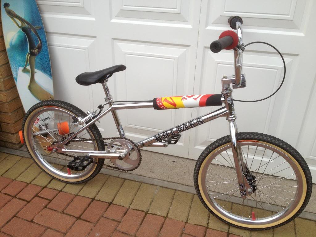

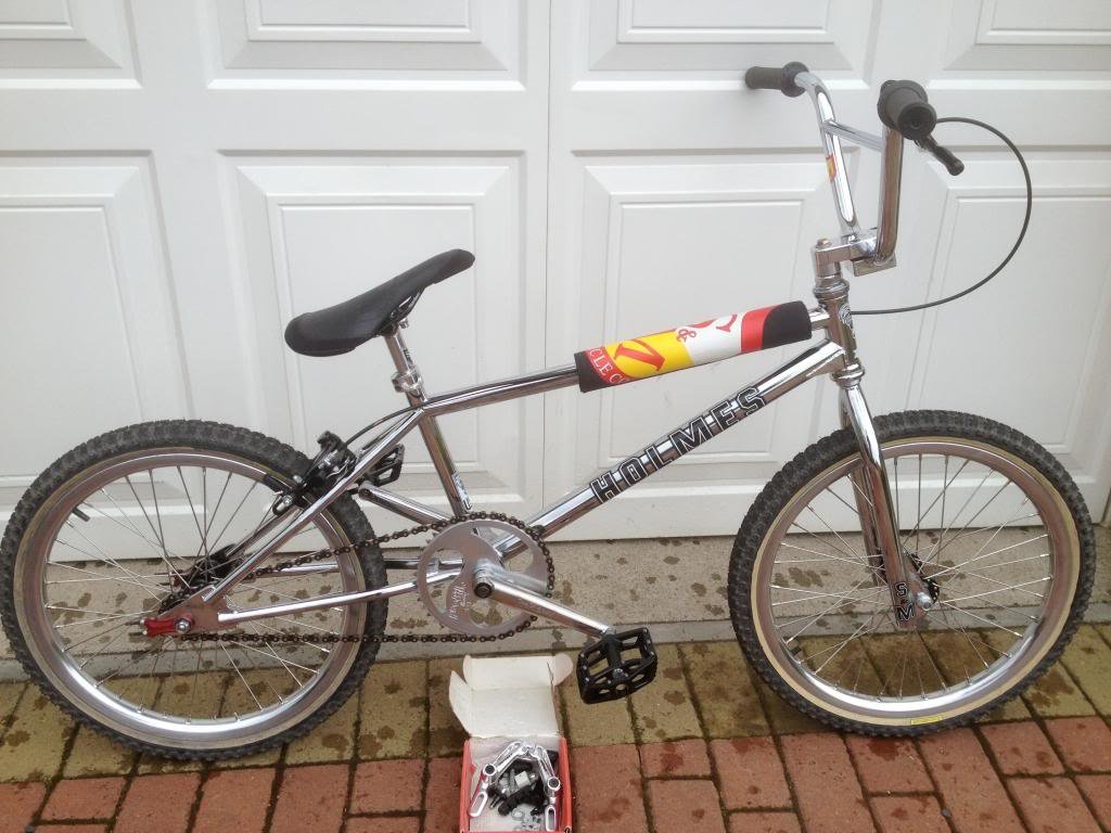

I've had a couple of hours tweak tonight . Shortened the brake cable and fit and set up he pitbull 2. Replaced black Taiwan tech 77 with black and silver Japan tech 77. For me it was more about the colour than the heritage:-) changed the tyres to pucka 1.75 dirtmonsters and filled the inner tubes with more air than I normally do.
It's dark so pics will be to follow.

I've slightly modified the Holmes since Rad went down. Primo Dirtmonster boots, ( correctly positioned on the rims in relation to the valve, after a bollocking from Gish )
seat angle tweaked again.
New seventies linear cable. I need function over era correctness here!
Pitbull 2 brake.
Since the first photo's I've tweaked the bar angle to an angle I find less aesthetically pleasing, but it has made riding the bike much better. I have tipped them forward 12 degree's ish to make up for the back sweep of the bars.
I still haven't got round to removing two links and fitting a half link to slam the back end, I will do this as part of the next Maclaren style upgrade package which will include shorter chain, freewheel upgrade, seat height revised( ( i'm still ball catching ), brake pad upgrade, brake lever tweak ( its reach is 5-10mm to far to for me use comfortably), and hopefully a conventional top load stem.

Nothing to see here. Just a boring tech upgrade. Changed the freewheel to a nos Shimano one. Took two links out, added a half link to slam the back wheel. Had a role around summerhill and it seems more responsive in terms of manualing ? Got home checked me tyre pressures , sub 45 psi. So I've upped them to 70psi.
Probabllies won't ride it much if at all between now and MK. Hopefully a nice top load stem will come up for sale before then.

gt dimple stem added :D
