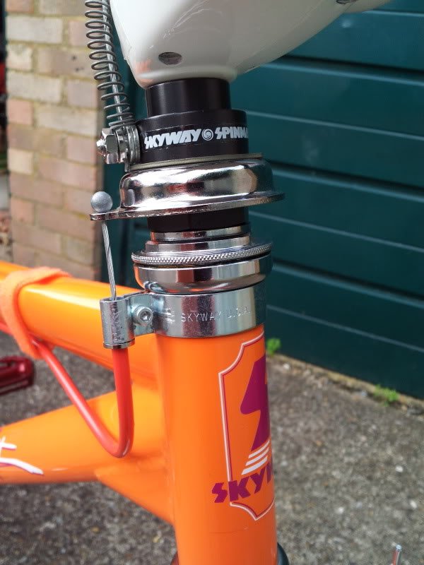

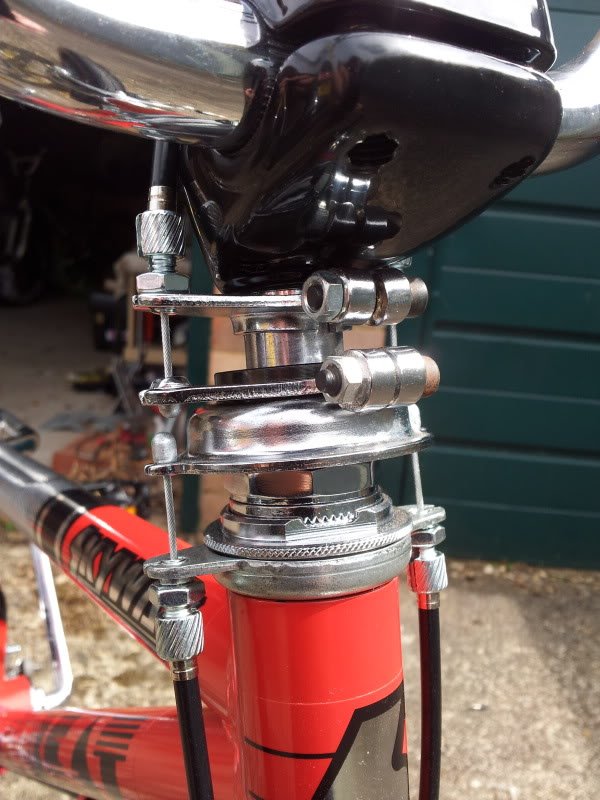

hi there,i have just got my hands on a skyway spinmaster and wanted to know do these go onto any headset or does it have to be a certain type,many thanks with any help
Re: skyway headset
« Reply #1 on: June 28, 2013, 11:49 AM »
they fit on any bike with a 1" headset as they don't actually attach to any part of the headset (you swap the headset locking ring for the black spinmaster ring)   a spinmaster works pretty much the same as an ACS rotor  :daumenhoch:
A spinmaster II works and sets up rather like an Oddy Gyro but slides onto the stem shaft and is a bitch to set up right  :daumenhoch:
Spinmaster
Spinmaster II
