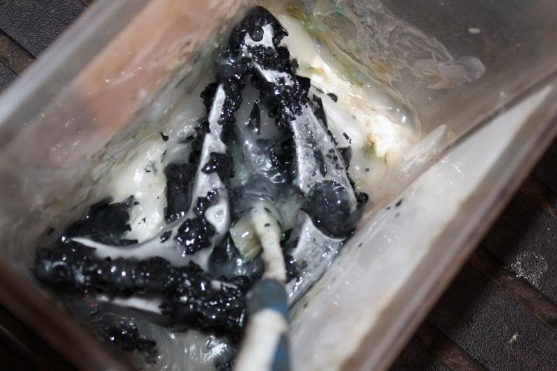

( I wanted to strip the arms on my brake so I popped them in a bit a Synstrip and gave them a light polish )

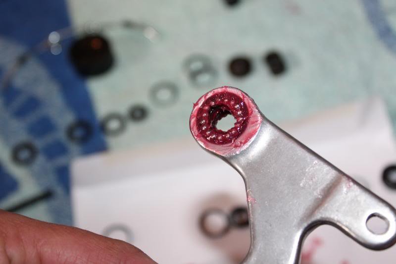

- Divide the bearings into 4 piles of 17. If the bearing races have dropped out of the brake arms use a blob of grease to stick them in again.
- Using a good amount of grease place the bearings back into the races on each side of each brake arm ... if you have a greasy finger this is useful for picking the bearings up. Get them roughly in position then use the small allen key again to position them... smooth the grease over to finish. This is fiddly but not as bad as it seems :-)

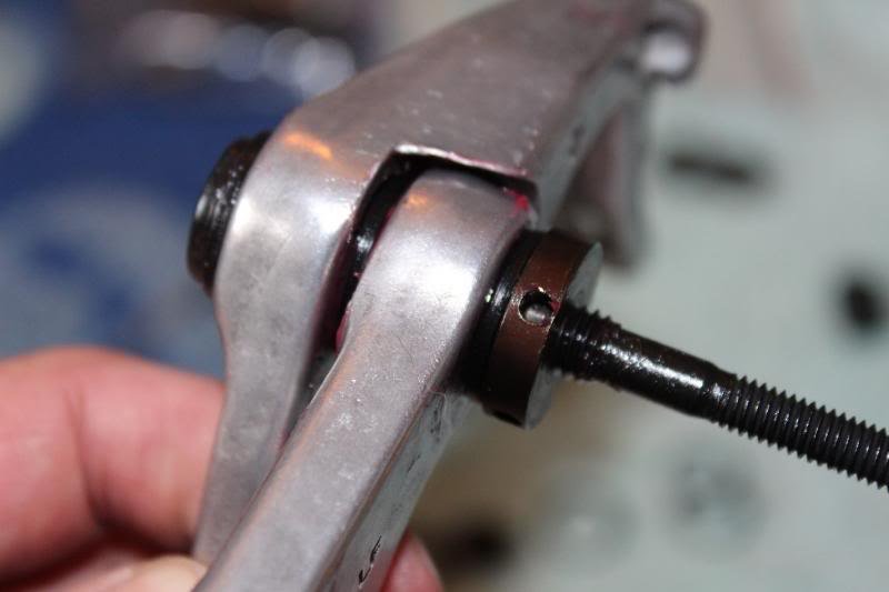

- Once you have done this for both sides of the brake CAREFULLY remount the new spindle getting the seals in the right position and right way round. Do the final tightening GENTLY as the bearings can easy pop out or you can mash the seals ... slow and steady :-)
- Tighten everything up and again screw the spring mount back in.
