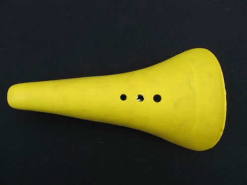

Last question - How do you clean kashimax saddles as the one i have is dirty.

Pics of the seat would be good but a decent cream cleaner and a foam scourer is a good place to start  :daumenhoch:

Personally i'd remove the guts and then throw the seat in the dishwasher to loosen the dirt, followed by a good scrub with everything you have under the kitchen sink.  They are surprisingly robust.......
If the rails and guts are rusty, or tarnished soak in a gallon of white vinegar (rail side down) for a couple of days, rinse and then give the rails a wipe with WD 40.  I did this with a pink Dominator and its looks good as new now.

Will do the seat tomorrow, straight in the dishwasher.
