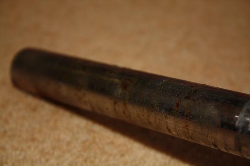

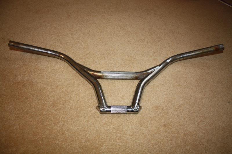

I took delivery of these early Kneesavers for my Team Master build today:
Although straight, they are a bit scabby in places:
There's no deep pitting, but the chrome is shot and that rust will not be polishing out :'( ;D
I plan on stripping them and getting them cleaned up and then re chromed.  They will then be sent off to SBD to powder/paint the lower section up to the cross bar (this lower section is the worst part, so a good job they'll be painted).
Does anyone have any tips for stripping/cleaning them up, or is this best left to the chromers to do the whole job?
Also, would you suggest getting the whole bar chromed, or just the sections that will be visible after paint?
And finally...can anyone recommend any good chromers in the N London/Herts area, and a guideline price i can expect to pay for bars/seat posts etc?
Thanks, Paul.

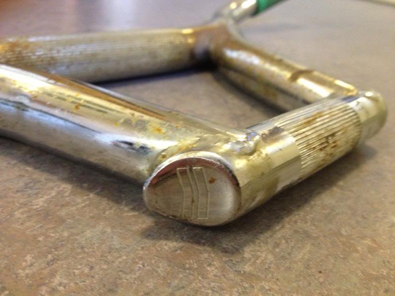

I reckon an Oxy bath would make the world of difference to them.
If you get them stripped, polished and re-chromed you could lose lots of weld detail and the Haro Chevron detail.
Have a look in the sticky section for some guidance.

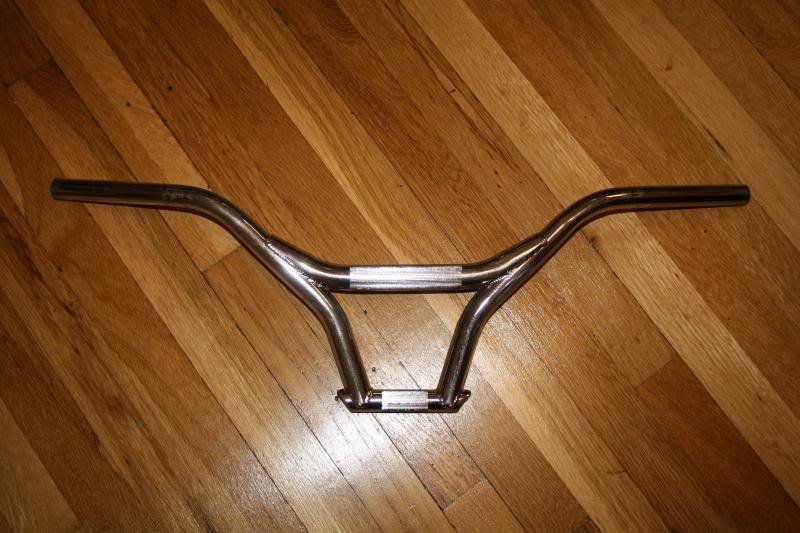

Here's how they looked before the bath:
I then added a few heaped tea spoons of the Acid to a tub of water, with the parts placed in it and left it for about 6 hours.  The Water goes cloudy and gives off an eggy smell, so i did this in my garage, which is well ventilated.
I checked on them after 6 hours, and then because i couldn't sleep, i gave them a stir and added a bit more acid at 5 am!
After about 18 hrs, the container looked like this:
I then removed the parts and scrubbed the rusty areas (most of it had disappeared) with a tooth brush and old scouring pad.
They were rinsed in fresh water thoroughly.

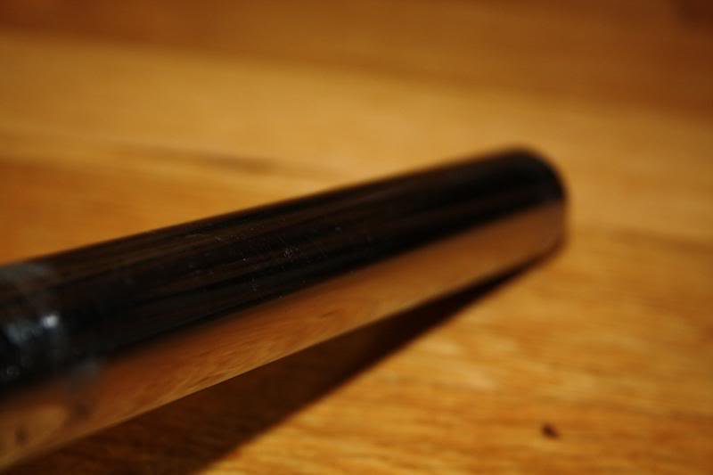

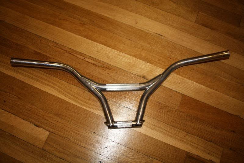

This is what i was left with after a clean and a polish:
Old dominator before:
After:
Bars Afterwards:
As you can see, the bars are far from perfect, but much better.  They will be good enough to be painted, and it required little effort. OA baths are a neat trick :daumenhoch:
