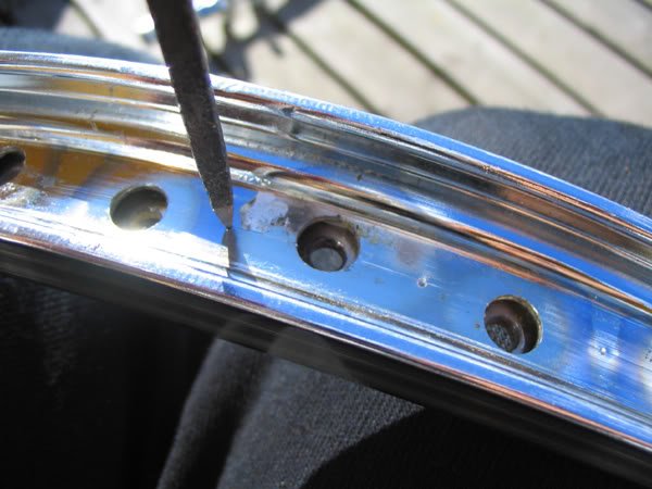

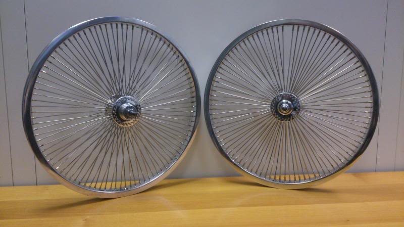

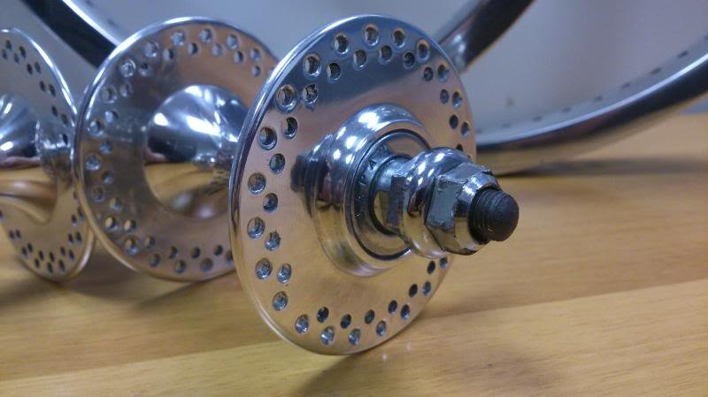

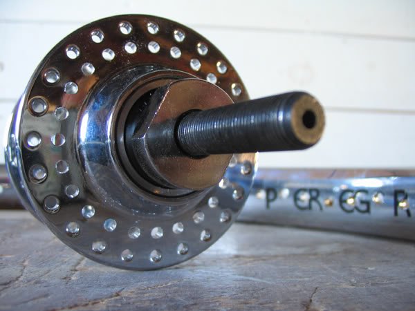

A couple of years ago, I bought a set of Peregrine Crazy 95's of Dan Harris and I absolutely love them!!
I got looking into how much work would be involved to make another set, mainly just for the hell of it I guess lol.  Well...that time has come!  :daumenhoch:

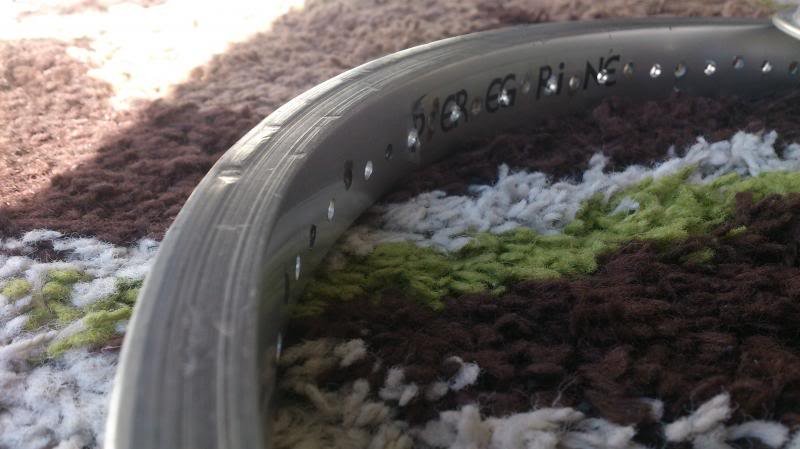

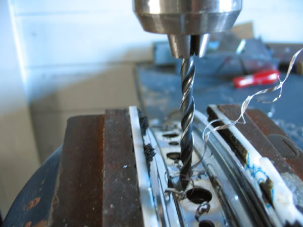

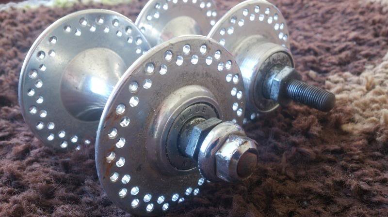

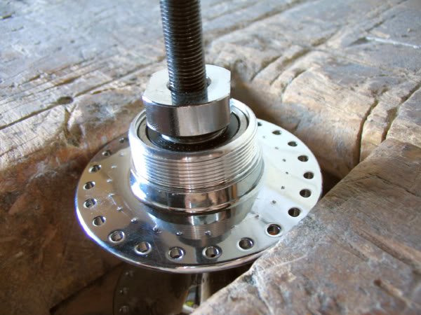

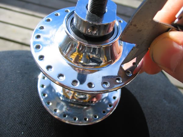

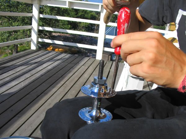

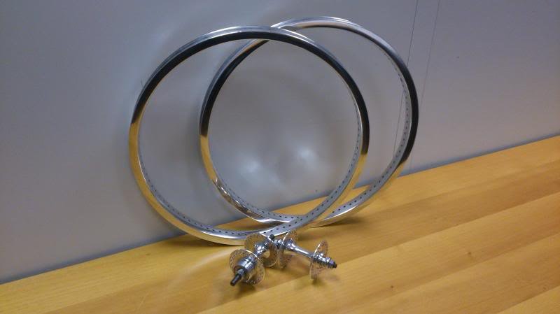

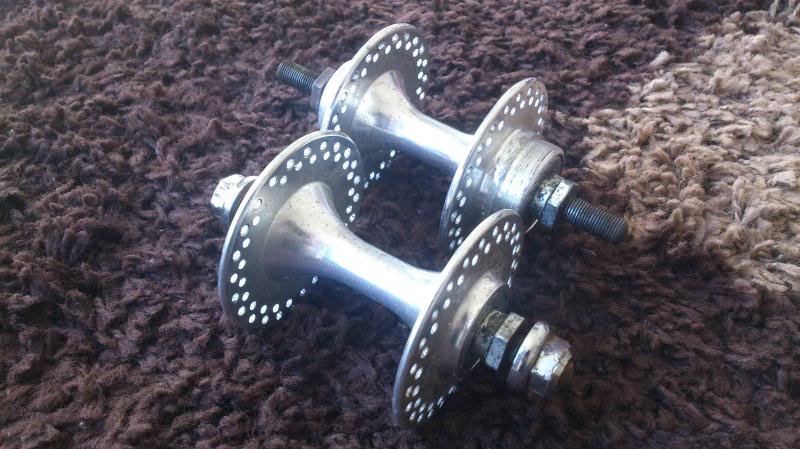

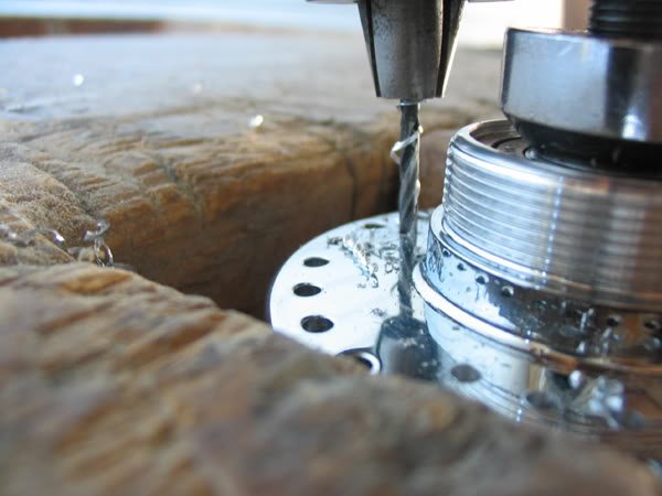

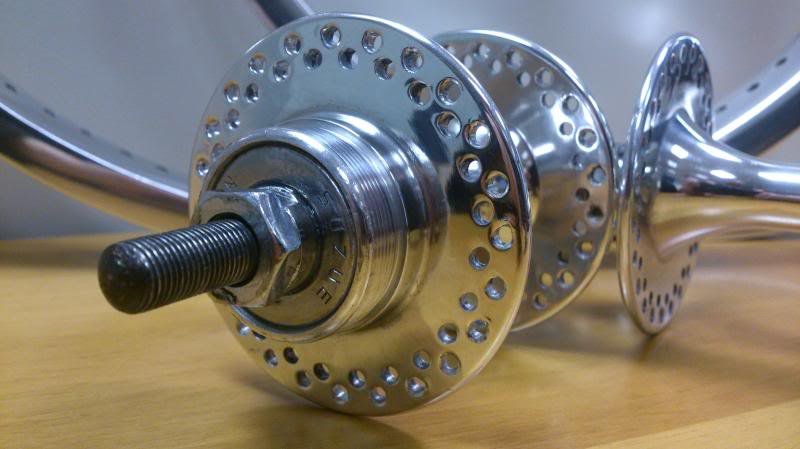

I bought a well used pair of Perry 48's off Rog "Adenough" ages ago and set those aside to be my donor wheels for the project.  I cut all of the spokes out to save faffing around and got stuck into marking out the rims/hubs for the additional holes.  Unfortunately I don't have any photos of the marking out but its pretty straight forward :) .  When youre drilling the hubs, dont forget to leave one of the "would be" holes undrilled.....this is to account for the valve hole  :daumenhoch:
So here are the rims and hubs after I drilled them out:

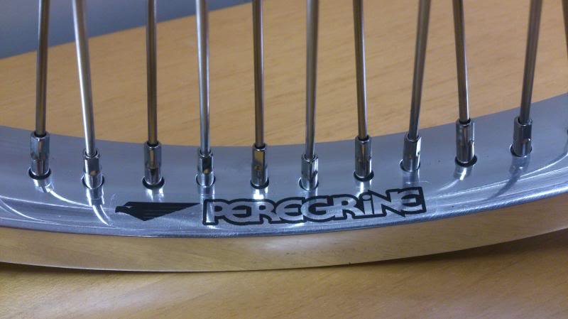

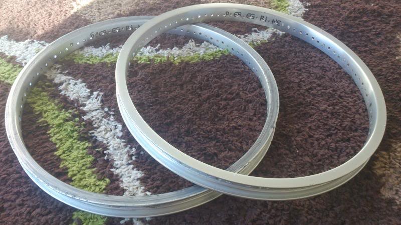

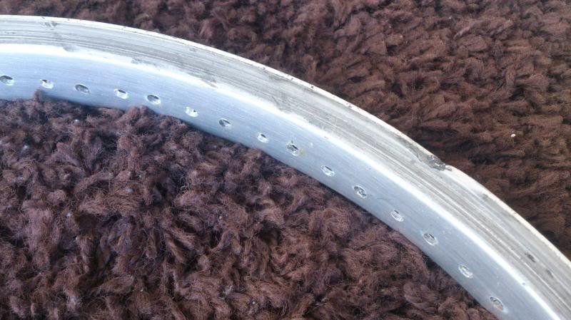

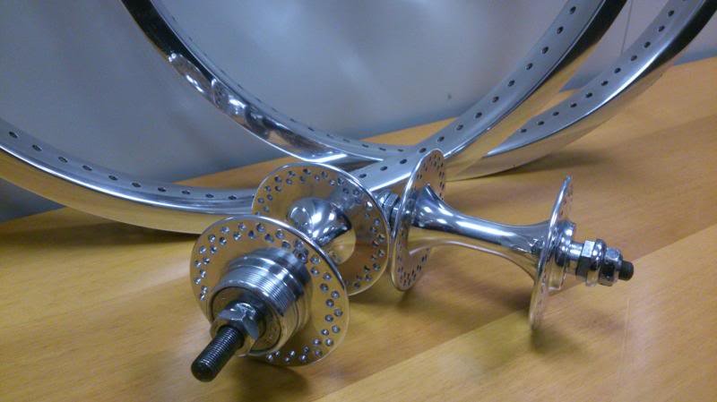

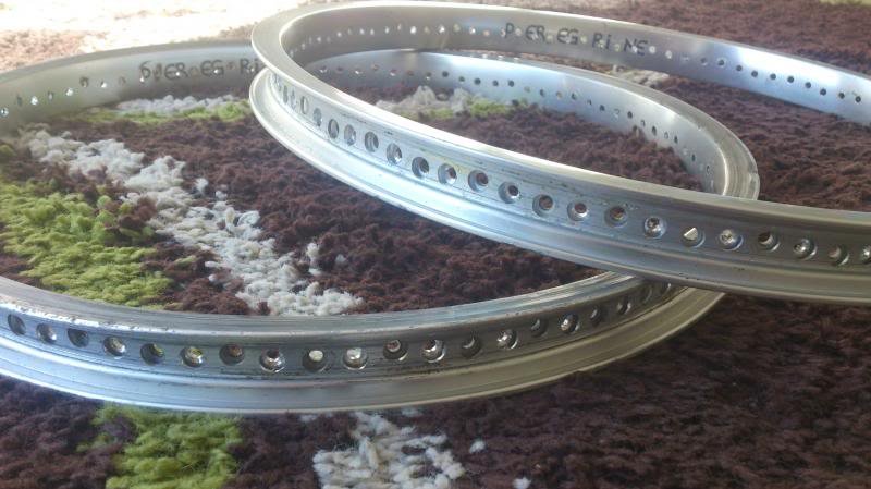

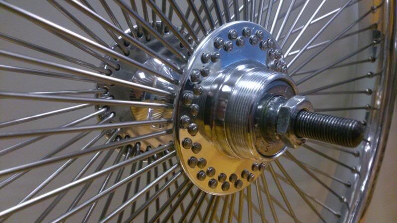

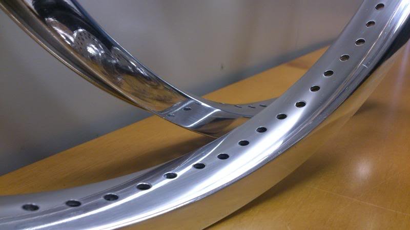

Next up came the polishing.....I got in contact with Joff "Norty40" and he welcomed these badboys with open arms!!  I wouldnt have done knowing how much work went into them! Lol.  I cant thank Joff enough for all of his help, the bloke should be King!!!  This is how they looked when King Joff sent them back to me  :4_17_5:

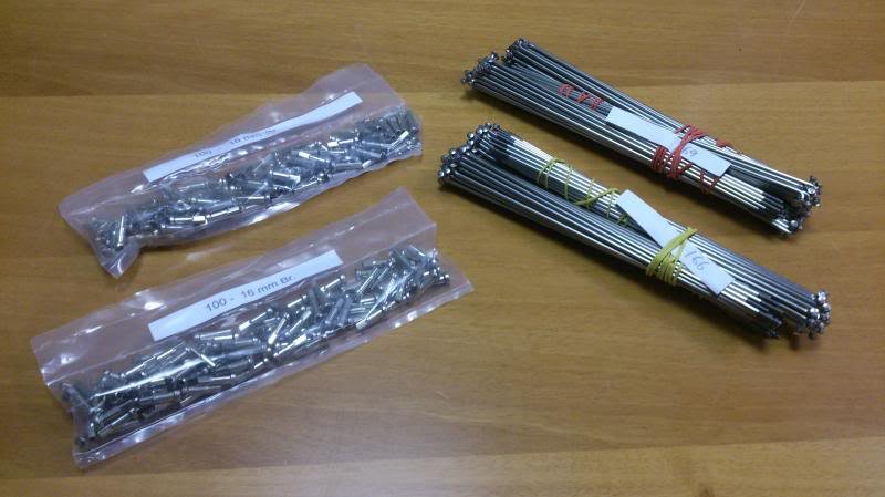

I also grabbed some "custom cut spokes" and long nips from Joff's mate while they were being polished...

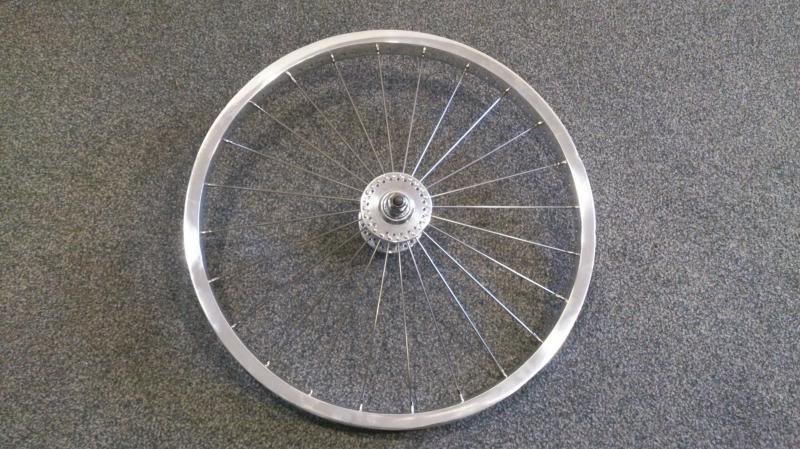

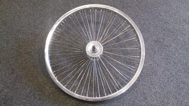

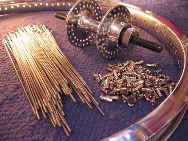

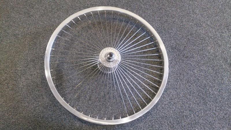

Once I had it all in my mits I set about lacing them up.....  Im not gonna lie.....it took me the best part of 5 hours to lace them both and get the tension nice!  But they were definitely worth it!!  Del helped me out too with some rim decals.......have a look and see what you think......Im seriously chuffed with them!!!!  :4_17_5:

 :LolLolLolLol:   Jeeeez Gav you didn't hang around , I knew you said you couldn't wait to get them built but you must of been up all Friday night  :D !!!  They look mental but cool  8)
Glad your happy with them mate and thanks for the kind words  :daumenhoch:
PS That front rim with all those dents was a swine to sort  ::)  ..... got there in the end though .

You did a proper ace job on them rims Joff  :4_17_5:  How the hell did you sort out them dings?
Re: Peregrine Crazy 95 Wheel Build...
« Reply #10 on: April 05, 2014, 08:49 PM »

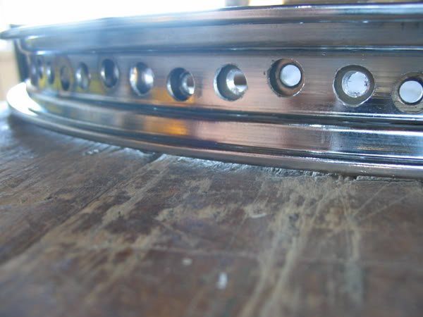

Cheers mate but tbh i just bought a brand new rim off ebay , re drilled and polished it ,  ended up losing shit loads of cash but at least it kept Gav happy  ::) :D
Seriously though , quite a bit of work , a lot of sanding to keep all the sides flat and true etc . I did PM Gav when they arrived and said the front one might be beyond me as i don't own a steam roller !!  It turned out well though in the end , you can't tell it's the same rim  .

Took me the best part of 5 hours today get them built but I love them!!  I want a pair for every bike now lol.

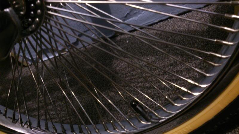

Yep the originals were radial laced mate  :daumenhoch: .  There have been a couple of variants on lacing these, a guy over on the museum a while ago drilled the holes on his hubs perfectly in line with the existing holes....just on a different pcd, and then lace them 4x.  It must be an absolute arse to lace lol.
The other set that ive got are radial laced too.....but instead of alternating the spoke length, the spokes were laced in pairs around the rim.  Ill dig some pics out  :daumenhoch:

Here are a couple of pics of my other set, the lacing has been done in alternate pairs around the rim  :daumenhoch:

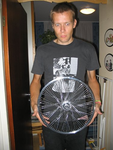

And also.....as a reference, these are the build pics from Museum member "2Fresh" .  These were lace 4x  :daumenhoch:
