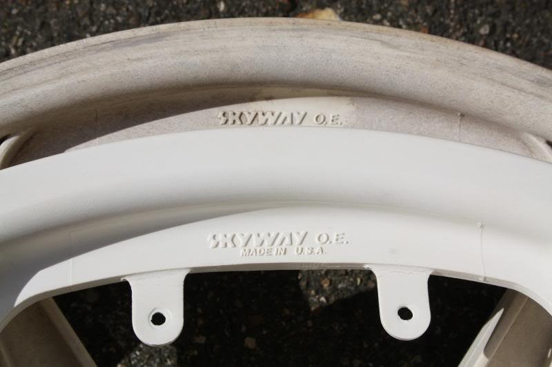

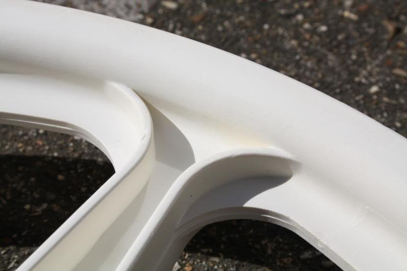

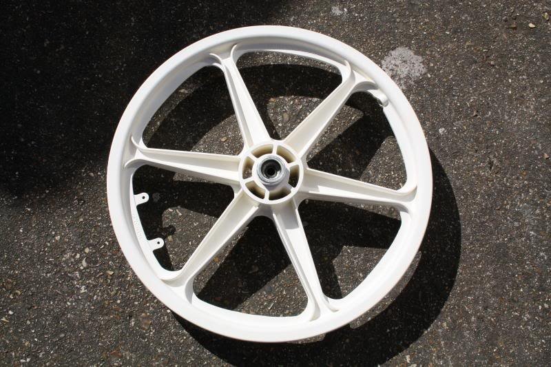

« Reply #5 on: April 16, 2014, 08:53 PM »
Taken a few days after they were done
Offline hokuspokus74
  • Posts: 1066
Re: Dyeing Wheels?
« Reply #6 on: April 16, 2014, 08:59 PM »
wowwwww excellnt job that what my oe's are for my decade build :daumenhoch: as for the rit dye is it powder form or solution...going to order it of ebay cant find anywhere that sells it

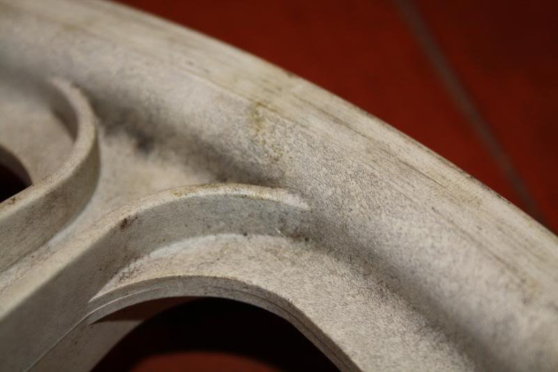

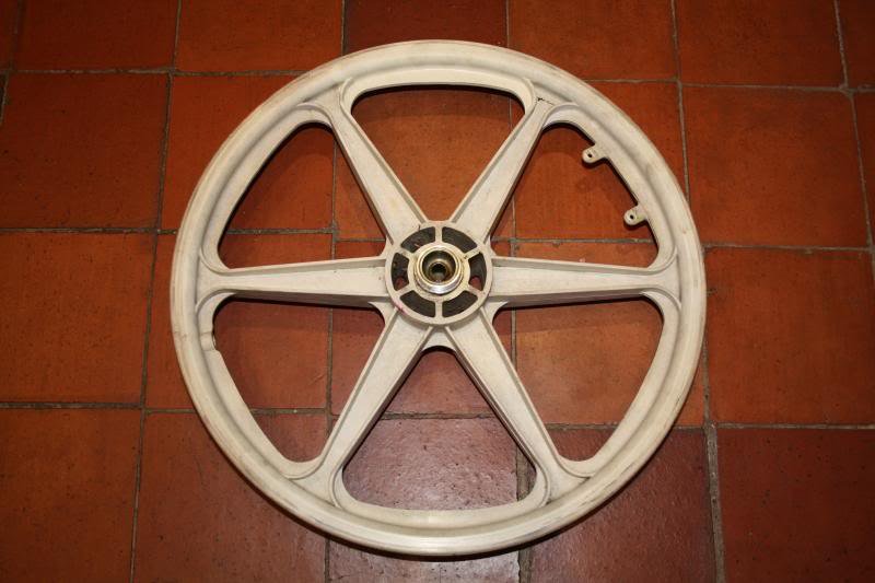

I have just bleached my OE's for my decade. They were awful before hand.  Before you try anything else, get a bottle of Cillit Bang with bleach, looks like this:
Spray the wheel, leave for 15 mins, scrub with a softish scouring pad and rinse.  Do this again a couple of times until it looks clean.
Just using the above method turned this:
Into this:
A comparison:
The result was so impressive, im debating whether to bother using peroxide on them.  Can they be 'too white' for a survivor? 8)
