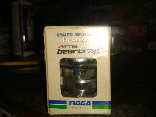

i have a nos tioge beartrap mtb headset and a mistral one, the tioga says cup o.d 30.0 cone i.d 27.0
