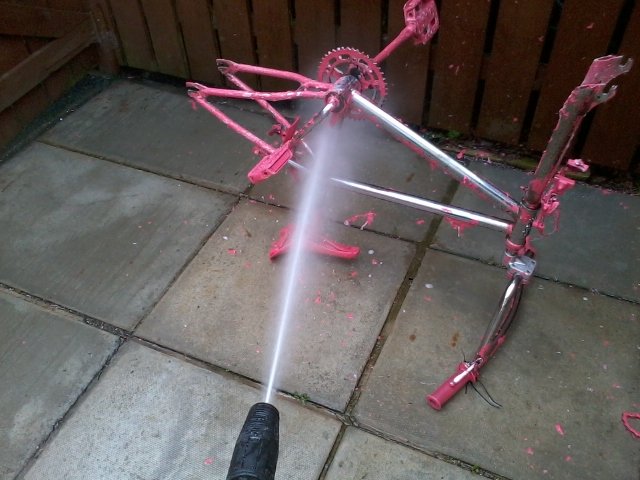

rodriguez
Re: Starchem Synstrip - Did not work ?????
« Reply #11 on: June 14, 2014, 01:06 PM »
Really liberal coating of synstrip and use a pressure washer   :daumenhoch:
