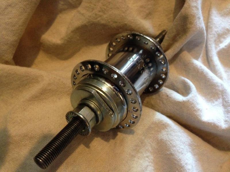

i've got a couple of sets of SuperPros that need lacing, after they've been rechromed.  I was thinking about lacing up a NOS Peregrine freecoaster into one, just to see what it was like, I've been told it will make a few tricks much easier..
^^That is what i'm considering.  It will need a sprocket though...
Offline Biggeorge
  • Posts: 253
Re: Tell me about....Freecoasters
« Reply #6 on: October 23, 2014, 10:07 PM »
Give it a go and see how you get on. Don't stamp on the pedal as the sprockets only have 3 little teeth on them. You might need axle converters if you have 14mm dropouts.
The lag takes a bit of getting used to but you'll soon forget its there.
There's some flatland tricks I do that need a freecoaster. There's others that it makes easier.
Hope you enjoy.
