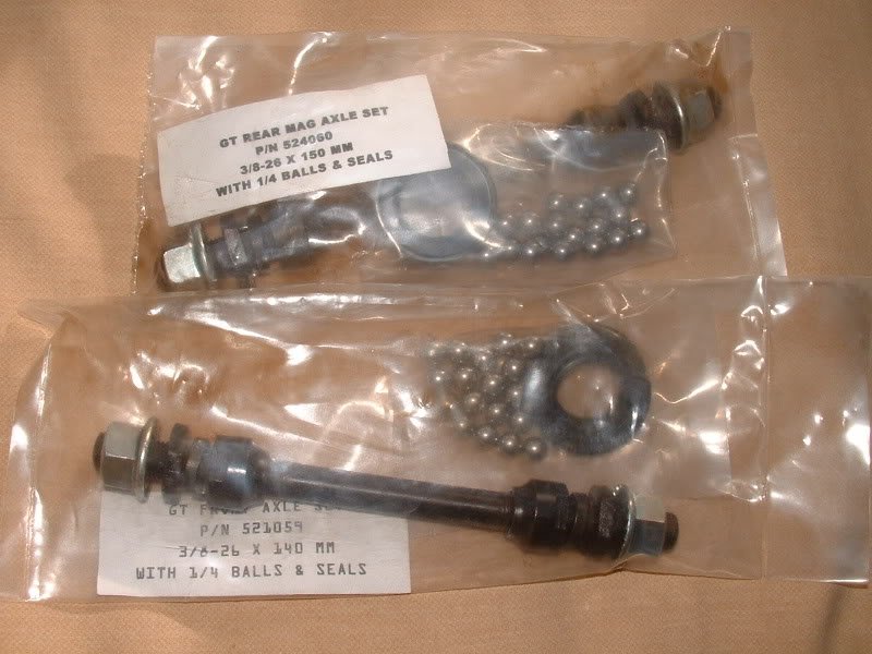

Cheers Marty, am I right in thinking they are the same as GT wheels?  If so I found a pic that might have answered my question......... could still do with a source for dust seals though........ I'm thinking I could butcher a couple of cheap axle kits for the cones with built in seals?

I used a couple of Bendycats axle kits in mine & they work a treat, got the seals built into the washers & everything.  If you're after the suize dust caps i've probably some somewhere  :chin:
