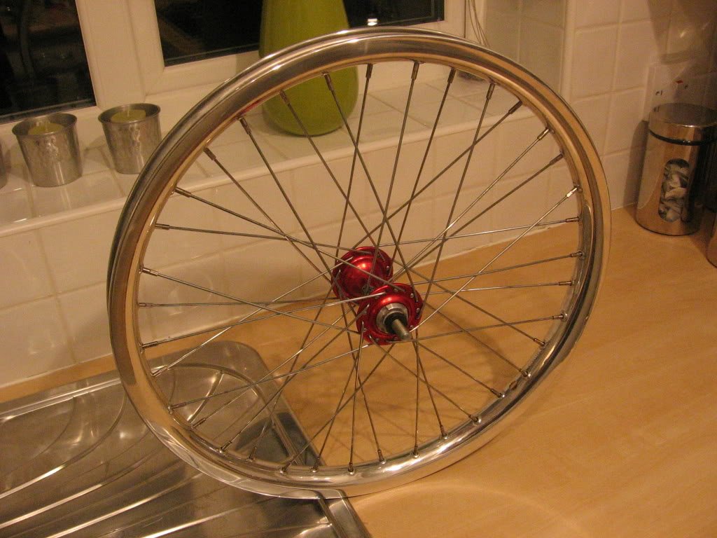

My first attemp at lacing... 3 hours later....

Lookin good, got two sets of 1 3/8 here need lacin to small flange suzue's, if anyone can tell me what spoke size I need might give it a bash myself.  Again nice work beard :)
steve
Re: One down... one to go...
« Reply #2 on: September 01, 2006, 01:02 AM »
220mm - ish

ta, when you say ish should I err on the side of caution and go slightly longer? or shorter?

-the peice of a4 =210mm
-its a low susie in a 1.3'8
-if you can get 218mm??? -thats em

« Reply #6 on: September 01, 2006, 01:27 AM »
you can't fook them up really
-the only thing you can get wrong, is from where you start-the way in which the nipple points from the rim towards the hub
-and putting the spokes through the right way
-the 'trick' is to have an already done wheel and putting the new bare rim over it, with the hub, to get the first set of spoekes in
