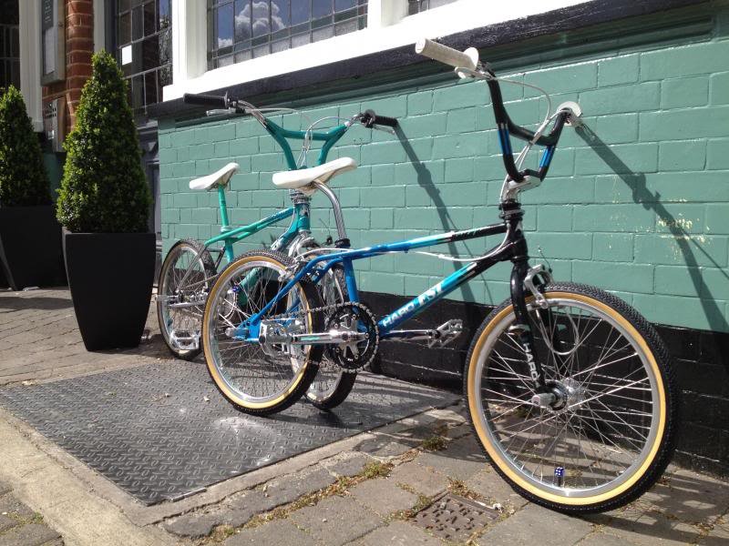

here's mine for some inspiration:

Here's mine an 86 with 87 paint and decals
