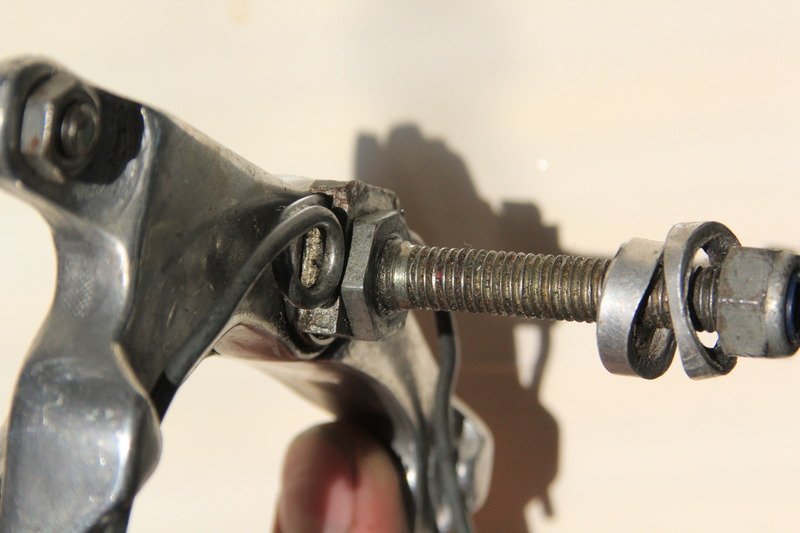

this is my 10mm reaction boa, it's not complete as i lost a bearing and the spring, it uses four sealed bearings so when tightened, it gives almost zero flex but still very smooth. best caliper brake ever.
it does indeed have a 3/8 26 tpi axle as i just tried a wheelnut on it and it fitted.
this is my 8mm one, it still uses 10mm sealed bearings but the axle reduces from 10mm down to 8mm.

To the cave with a vernier  :teef:

Any numbers on the bearings John ??? Boas measure at 18mm & Little bearings are 17 or 20mm

there are no numbers on the bearings but i ordered a vernier caliper the other day, so when it turns up i'll get the sizes of them.  :daumenhoch:

Bet they're old odd skateboard wheel bearings or something daft. They look a snug fit from your pics & the boa arms don't appear to be modified  :chin:

Yes pretty sure they had skateboard wheel bearings in them  :daumenhoch:

Nah... skateboard wheel bearings are LOADS bigger ... will take a pic if I can be fooked  ;D
Thanks for the pics tho John  :smitten:

just measured the bearings used in the brake. o.d is 18.97mm, i.d is 9.99mm and width is 5mm incase anyone wants to have a go at making one.  :daumenhoch:

Easily found at those dimensions  :daumenhoch:
