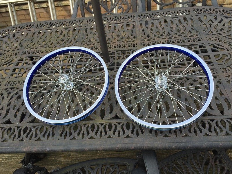

I've got these Araya 7x for a custom build I've got on the go at the moment , they have been painted candy blue but i really like the shiny side look , so i set to work .
Now I'm not saying this is the best way or even the right way , this is just what i did  :daumenhoch:
The first pic shows how they were before.

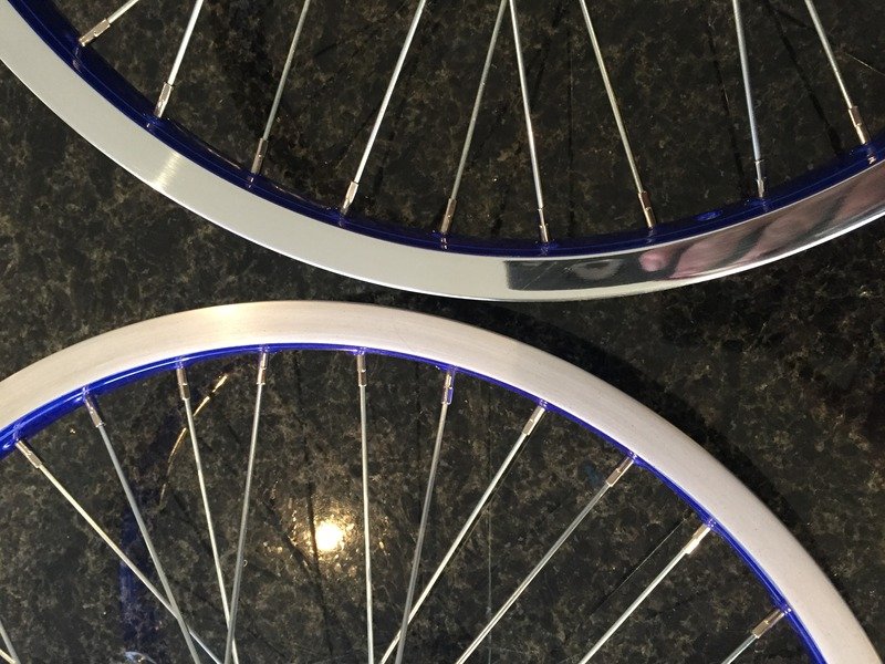

I started by carefully sanding round the rim using my little orbital sander using a 180 grade disc , just going steady and keeping it as flat as possible on the rim.
When all the paint was removed i then hand sanded with wet and dry starting with 240 down to 600 grade paper this left quite a nice brushed alloy sort of satin finish
I haven't got a polisher so i improvised and used my orbital sander with a micro fibre cloth cut into circles stuck to it .
I went round em a couple of times with autosol and then a couple of times with peek and buffed em up by hand .
I'm proper chuffed with how they've come out so i thought id share with you guys incase anyone else fancies a bash
the pics tell more of the story  fistblump
initial sanding
wet sanding
this is how they looked after all the sanding
A makeshift polisher
1 polished 1 not
done

I'm hard to please but looking at the shits how did you get the grain of the sanding to follow the rim so accurately - looks machined!! You could make a career out of this
Re: So this is how I shiney sided my wheels
« Reply #16 on: February 29, 2016, 08:13 PM »
Great thread.  :) Great results.  :4_17_5:
Offline benno
  • Posts: 3888
« Reply #17 on: February 29, 2016, 08:21 PM »
Just followed the curve of the rim by hand mate , I did wear through the skin on me finger though 😂😂
