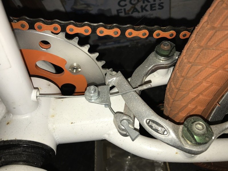

Hi all, I'm an old school guy but built a mid-school as a rider to see how I get on. Anyhow, managed to get mostly everything to fit and work but the rear brake ain't happening. It was missing the bridging cable and little clamp bit, so made a cable up and bought a generic clamp but its rubbish. I have tried to track down the correct bits but no luck. Do I need to just replace the whole brake? Any info would be much appreciated 👍

I'd say lengthen the bridging cable. Doing that will allow the arms to squeeze together more, as it is they're being pulled almost in a straight line towards the seatpost because the cable's not long enough to bend either side of the clamp. It's hard to describe.
Try to get the cable bolt on the clamp to go quite close to the seatpost when you pull the brake.

That's some great advise Wayne. The cable I made is non-adjustable but have seen cables on the bay (quite long) but no adjustable clamp. Totally get what you are saying, I have made the cable so short, it is stopping the brake from functioning correctly. I will buy one of the long cables and see if I can get some suitable clamp to allow some adjustment. Thanks Wayne, much appreciated

which brake calipers are you using ?
you just need a straddle cable, clamp and a hanger
cable can be an old brake cable inner dosn't have to be a specific straddle cable , use barrel on the cable for one side then one of these at the other
http://www.customriders.com/prodshow.asp?prodid=15680&cat=89&parent=1001&sid=3
or use two of the clamps on the old cable
lots of different hangers on the market,   as an eg
http://www.customriders.com/prodshow.asp?prodid=19128&cat=89&parent=1001&sid=3
if your brake has two barrel slots then this is job done in one go
http://www.customriders.com/prodshow.asp?prodid=20309&cat=89&parent=1001&sid=3

the good old "NARP" standardbykes invented those for shortening floppy old shitty gyro cables, back when people started running smaller/narrower bars! there very handy and cheap so I would buy maybe two or three, so you can then use *ANY* old bit of cable as a straddle ;) the springs look very slack on that hombre the top-
-covers/nuts (green alloy) should be at 90degres, to ensure a nice solid recoil back to neutral when the brakes released 8) 8) 8) 8)

  just be carefull if you order any  some of the "Knarps" are for giro cables such as the odyssey ones , they are smaller than the "clamp" i posted the link to,  which is for a calliper straddle cable  :daumenhoch:

Thanks both, you have given me a wealth of info there and I have never heard of "Custom Riders" before, will be ordering loads now lol. I think it's a Hombre brake. It came with the frame, so don't know if it's just cheap rubbish or worth getting the bits for it. Don't want to spend a fortune on the bike as it's just a rider but new brakes seem very reasonable compared to old school parts. I like the look of those alloy hangers, look a lot more functional than the little metal ones. Thanks again both, I love this hobby and the community!!!

the d/c-hombre brakes still one of the best u-brakes ever made, I'm still riding a pair of mk1 d/c-hombres from 98 ;) ;) ;) ;)
on the left hand side of the brake is a "knarp" clamping the cable, just one of there many handy uses and possibilities :coolsmiley: :coolsmiley: :coolsmiley: :coolsmiley:

Ah I see what you mean now. So it can be used as a side pull instead of a centre pull. I'm going to order a few bits and try a few different setups, just to see what works. I'm pleased that you rate the brakes, I hate buying new parts just cause I can, it's a waste. Cheers for all your help buddy

Just an update as only just found time to put the bits on. Looks like it all functions a lot better but will have a test ride tomorrow. Thanks again to everyone who gave advise, it's much appreciated
