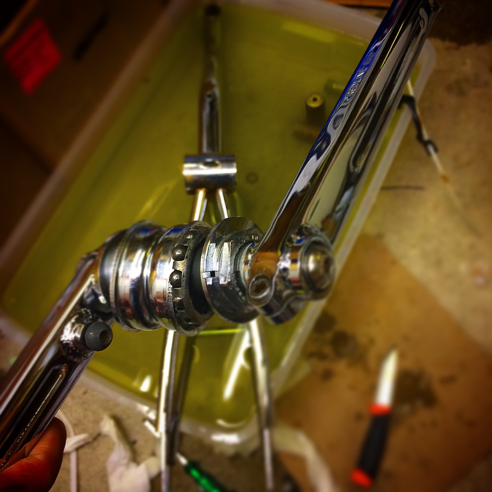

TC I usually use a 3 ring 1m paddling pool. it's needs to be distorted slightly to get a frame to fit but that also helps in reducing the volume of fluid needed to cover the frame.
tubs full of water placed in and around the frame will also help reduce the volume needed and therefore the citric acid is needed.

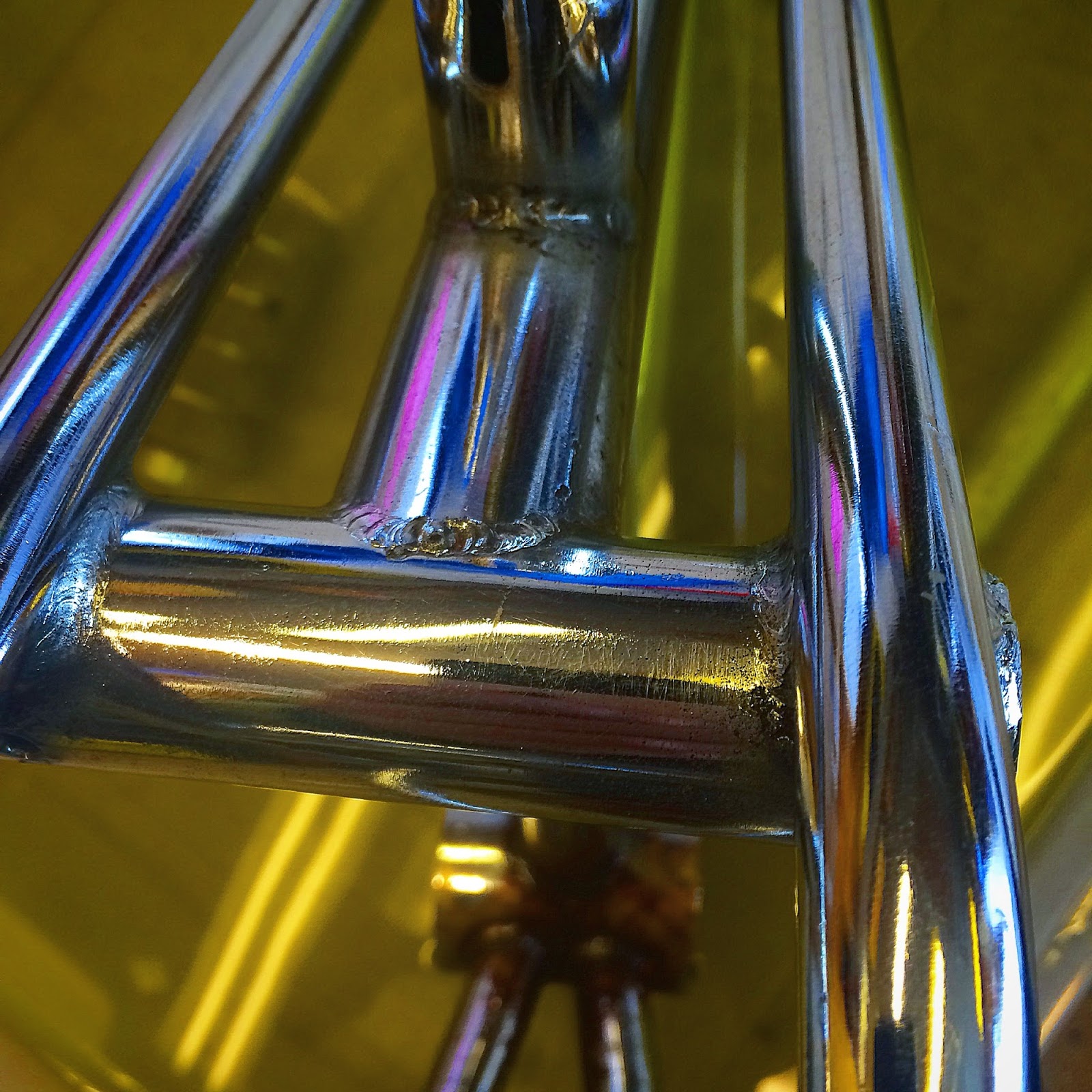

Regarding the lifting mentioned above, the chrome HAS to be already lifting in order for the water to get underneath it!
citric acid will not penetrate secure chrome!  There are a ton of thread on here with successful results and I personally have had fabulous results on numerous occasions.
contrary to duff info you may read on the net aluminium foil WILL remove rust BUT the chrome and rust particles becomes lodged in the foil turning it into a harsh abrasive.
it's great on axles, spokes etc but WILL DEFINITELY scratch your chrome.
As with anything, do your research. The Tech and resto pages on this site are some of the best out there and a wealth of information  :daumenhoch:
Citric acid or oxalic acid will only remove rust! if the rust is the only thing holding your bike together it will not magically rechrome you bike for you.
We must also remember that not all chrome is equal. some is laid down over copper then nickle, other stuff is just laid down as cheaply as possible. As with most things prep and the environment is key!
All things to bear in mind when dealing with chrome  :daumenhoch:

So to summarise:
Aluminium foil can be used with water to remove rust but risks scratching the chrome.
Citric acid can be used to remove rust, but risks removing the chrome entirely
This correct?

Citric acid does not lift chrome.
The frame in question had issues with the chrome (that's why the owner tried to recover it).
Citric acid, and other weak organic acids, is harmless. Yes the word 'acid' sounds scarey but it in this case it is weak lemon juice.
Citric acid is the primarly cleaning agent in most eco-friendly cleaners.

Used citric many times on bikes, full chrome frames (87 pft) and also with decals and paint (88 master).
Chrome, decals and paint all survived with zero issues.

Used Oxalic acid loads of times (as much as a whole bottle at a time with no issues whatsoever & soaking the parts for 24hrs at a time. It doesn't touch the decals as its not strong at all & will only at eat rust,  so any frame thats had its chrome eaten into will have had massive issues beforehand.
