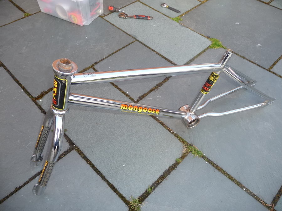

Great piece of your history you've got there.
You're doing the right thing not selling, it obviously has a lot of meaning and sentiment and you'll find that once it's gone, you'll regret it and buying another will be costly and unless the person you sold it to decides to let you have it back, you'll have lost your history.
Mechanically, do what you did in the 80's, strip/clean/grease and build. Clean all the plastics and other bits and only replace things that are beyond restoration. Nothing looks too bad on there to be fair.
As for the chrome, try an oxy bath. I've never done it myself, but have seen loads of people having great success doing it, you just need a paddling pool full of water and some citric acid. This will clean up any chrome work, without harming the decals.

Strip it down and give the f&f and any other chrome parts that may need it a citric acid or oxalic acid bath.  Clean all the other parts, re-grease it and put it back together... good as new.  :daumenhoch:

Defo just give the chrome a clean as already said.  I've given frames similar to that oxalic baths and they come up amazing .. you'll be surprised how good the chrome is under that rust.  you're going to erase all the history of that bike stripping off the original decals and painting it.  It's only original once.  :daumenhoch:

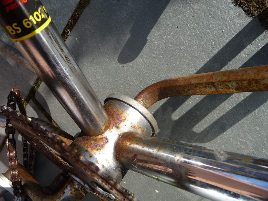

I made a small start on the restoration tonight.  My mother has broken her ankle so I'm spending every other two nights at the house where I grew up, swapping with my sister.  So the start of the work is happening where I did all my maintenance as a kid which is pretty neat (but not for my mum, obviously).  Anyway, I started with the seat post as I'd read they were often a pig to get out.  The clamp seemed fast so I strayed it with some WD40, left it a while and then I got it loose and removed the post without any trouble.
I've loosened the stem bolts, removed the horrible pegs and started to remove the pedals.  The left pedal came off pretty easily but the right appears stuck fast (I do remember the threads are opposite).  I've resorted to WD40 again so gave it a spray and left it while I write this.  The pedals are Shimano SX rather than DX but have lost their caps and most of the grease it appears.  I also own some original DX too but they have a 9/16 thread (3 piece crank), I'm running these on my mountain bike but probably should stop doing that as I guess they are worth a few quid now?   Back in the day I first ran an aluminium three piece and got the DX for that but the three piece wore such that you couldn't get it tight so I swapped to a one piece.  My paper round didn't pay enough to also purchase another pair of DX so had to buy the cheaper SX.  I did manage to swap the spindles from the SX to the DX (without watching a YouTube video!!!) and use the DX with the once piece.  The DX are in much better condition so may be I should think about swapping spindles again?

This gives you some idea of how effective an Oxalic acid bath is ...

Does anyone have any tips for getting the bottom bracket undone after 30+ years.  Mine seems stuck fast!  I'm turning or at least trying to turn clockwise.  I've sprayed it a couple of times with WD40 and given up for the day.
Have you tried turning it anti-clockwise ?

Had a go both ways but as far as I can tell from running a small screwdriver around the visible thread it's a left handed thread.
J
You're right it is mate... keep blasting it with loads of WD40 and keep working it back and forth. It should come loose with a bit of jiggery pokery.  :daumenhoch:

I got the bottom bracket loose this morning, I used a bigger spanner!!!
The coaster in the rear Skyway was bolted in rather than riveted in so I decided to remove that to make it easier to clean.  Unfortunately, spindle and inners worked loose in the process so I need to rebuild that.  It was probably a job I needed to do anyway and looking at the guides it's not as difficult as I first thought.

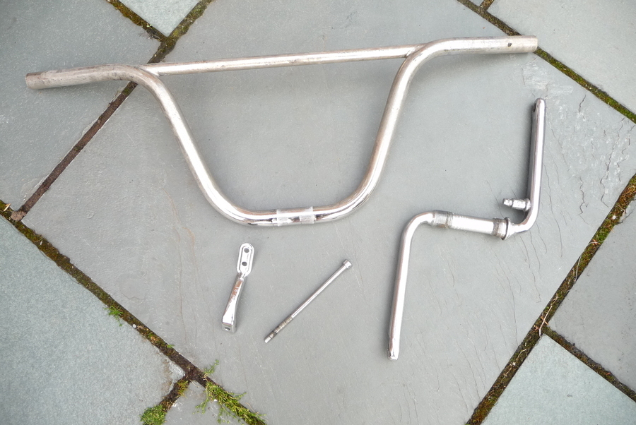

Has anyone used 'Kool Stop Continental Brake Pads' as replacement for Tuff Pads as mine have had it?
The bottom bracket and headset seem servable or would you recommend replacing to freshen things up.  The branding stickers around the headset have gone.  I've also realised that the stickers onthe forks have gone.  I must have removed these in the past at some point.
I'm going to replace the spindles in the MX1000s as the original nuts are missing.
What does everyone do about cleaning up nuts & bolts?  Do you use a degreaser and Citric Acid or other substances?  Ideally as eco friendly as possbile.

I've always used Kool Stop Continentals on Skyways,since '82 in fact. Go for it.
