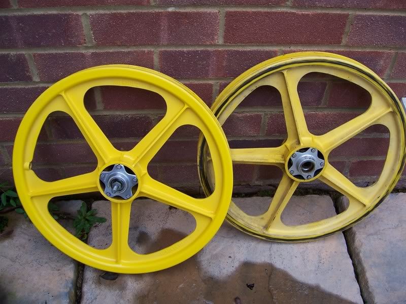

after being taught to use the jedi mind trick by tuffmaster rombloke i thought i would have a go, just gotta find another 3 hours to do the other one

tried bleach mate no joy so tried man milk still no joy so used the rombloke method, still cant beleive how well it came up

Who did you find to ship you a NOS wheel in 3 hours? :)
Looks amazing, you got the shine back which makes a big difference. Is that the WD-40 trick?

That looks great, I have two very sun bleached Tuffs to do too so I hope mine come up looking like that one  :daumenhoch:
Was that done with Dylon Multi Purpose Dye in Golden Glow?

no dye at all marty, i used the rombloke trick
Got to be the WD 40 trick then cos in his tuff resto thread he says he uses dye  :-\

so he didnt tell you about scraping the top layer off with a stanley knife first then? bugger have i just told you something i shouldnt
Re: a tuff job
« Reply #12 on: October 12, 2006, 09:03 PM »
A stanley blade, all over them?  Must have taken some time!

yep 3 bloody hours

lol...i only dye badly faded tuffs...for a quick resto, scrap the rim clean of brake residue with a stanley blade, dragging it as apposed to cutting, then hit the rest of the wheel with 800 then 1000 grit wet and dry, then the obvious......wd40

I think mine will need dying....
They are actually yellow  :LolLolLolLol:

more like magnolia...hehe

just had a look and it is still the same colour, well chuffed, just gotta do the other one now
