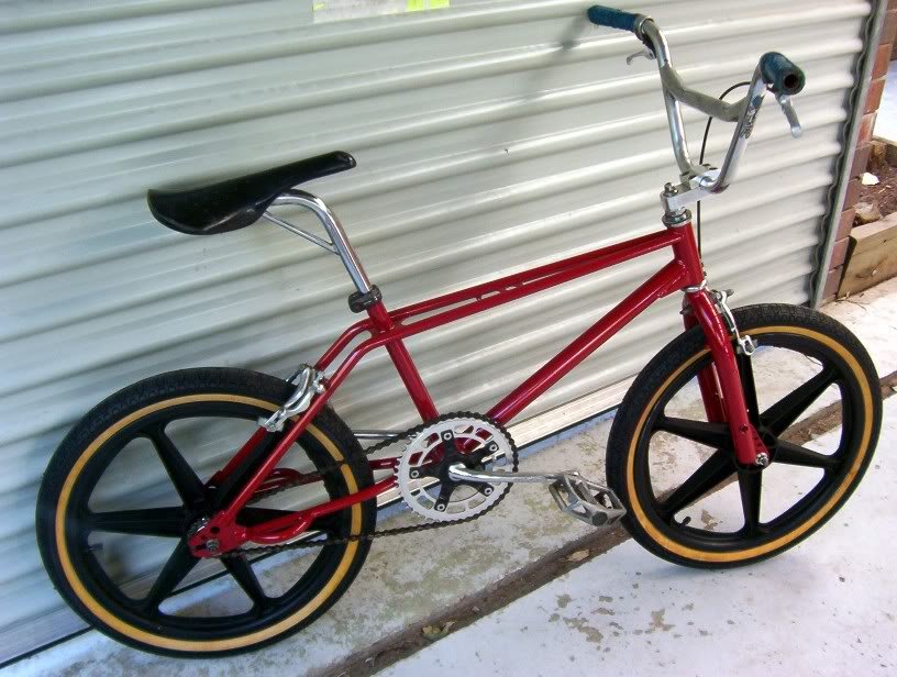

When I got my frame powdered, it was done with chrome-look powder then candy red over that. It looks great in the sun. You cant tell indoors though. He went a bit heavy with the candy red. You can still see the serial numbers though.
