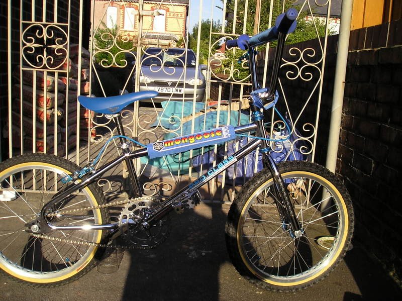

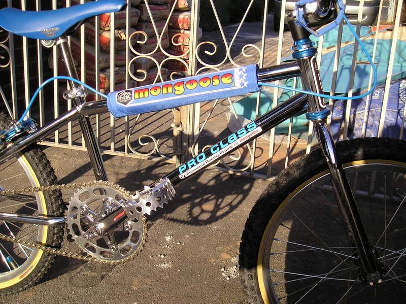

i must say stidds pro class is the best atempt at black chrome ive seen,i thought about doing mine in a similar way, but the factory riders always had normal chrome so thats what i  went for

Stidds Pro Class is awesome... I spent most of the weekend sat next to it with my eyes wandering over it. I had Sawzalls Dreamy Pro Class the other side too..... heaven  :smitten:
  Thats a Beauty too Mat...  :coolsmiley:
