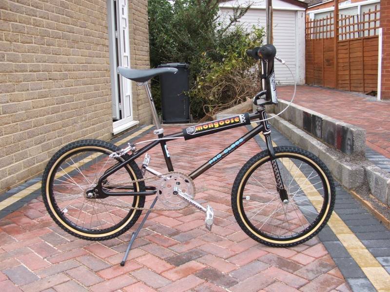

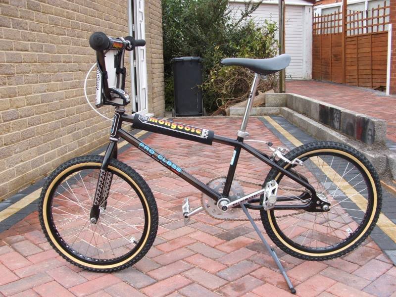

When I restored the smoked chrome finish on my Pro Class I used tinted lacquer, this is how the original Pro Classes were finished, they were not a chemical smoked chrome.
I went to a local car paint manufacturer and told them what I wanted and they made it for me.  I asked for a light tint with a hint of brown (Mongoose used a hint of brown, Diamond Back used a hint of blue for the HL Turbo).  I applied about 6 light coats until I had the shade I required.
What you need depends on the use, obviously powder coating is tougher, but as my bike is a show bike I wasn't so worried about the toughness of the finish.
This is the result.
