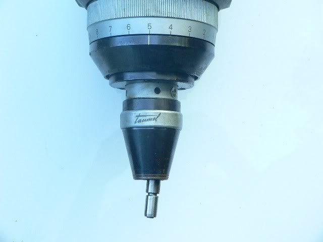

The problem you guys will have here, is that you need an orbital riveting machine to fit them.
Its not like a normal rivet where the heads are bashed over, the press tool is rotating, on an angle about the rivet.
The machine allows for different speeds and pressures, depending upon the application.
Skyway used a Taumel Orbital rivetting machine.

currio
Re: SKYWAY FLANGE RIVETS
« Reply #18 on: November 20, 2006, 06:26 PM »
Here is a pic of the head of the machine, to give you an idea.
If you know someone who works in a machine shop, you could get them to make the bush, with an angled hole, and to make you a rivet.
It may be possible to then use it in a pillar drill, there is loads of them around.
