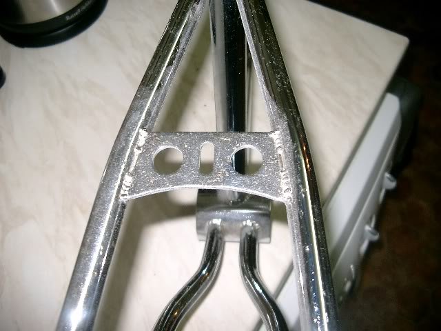

seen as there allways confusing over these things and had this one for over a year now and was wondering as different to others i see ie oval tubes

brake bridge but no kuwahara stamp

i know it tange as serial number are same style ie place and numbering as my aero pro that tange made . now where the kuwahara buff showtime as he might know and if it ain`t what is it ie what tange

the tubing is too "pointy" oval to be a Laserlite & the brake (although right shape) doesn't have nough weld on it! the Kuwahara ones are welded all the way up both sides ;)
as for being stamped this was only on the 84 & later bikes so depending on your serial number that shouldn't be an issue!
also you look to have the right dropouts, flattened stays on the inside & welded both sides etc  ;)
however to my knowledge Kuwahara didn't make a frame with tubing that ovalised  ???
its still Tange made & a nice Aero frame but i'd say not a Kuwie, Tange made bikes for quite a few companys back then
have a nose round jamies site for more detailed information ;)
nice fram tho, i like it  :coolsmiley:

still not sure as just found a advert on nsr site and that says the new kuwahara with oval tubes . i email him to see what he thinks .frame is welded same on both side on brake bridge

I think I agree with Showtime on this. My KZ 83 has the oval tubing but it is much more subtle. Also re: the brake bridge, I don't think the two holes are an indicator of Kuwi as the pic below shows a different type plate with two holes, albeit different sizes and also the plate is welded on top of the chainstays rather than in between.
Where is the serial number and what is it? This may help.

what i meant about the welding on the brake bridge was it doesn't go all the way along the edges like every Kuwie i've ever seen, yours has a small gap in the middle ob both left & right hand sides!
my serials are (KZ1) K1J0711 the K means Kuwahara made, 1981, J = October, 0711 is the individual fabrication number
my Laserlite is T3G2062 the T  means Tange made, 1983, G = July, 2062 fab no as before
all the Kuwie/Tange made bikes should have frame numbers following this format ;)
apart from a couple of very rare KGB numbered sets ???
a pic of 83 & 84 rear brake bridges (84 is stamped)  ;)

 My factroy team laserlite is from 82, and has mega aero tubing like that allthough the brake bridge is fully welded. i would be sure it was a kuwahara if the serial starts with a T then  number, then a letter between A and L then more numbers. Mine is T2L0005 the 5th one made  :yahoo_silent:  The 83 models got less oval and then in 84 well, you know the rest.

basically 83 Laserlite tubing is not true oval! its like fatter tubing thats been flattened a bit in the vertical plane making a rounder oval shape rather than a pointy one  :daumenhoch:
the full frame number would definitely help  :police:
