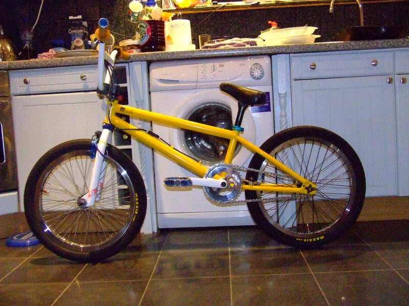

here it is ... better pics soon .. thanks to superbikedan for the powder its turned out brilliant.
Re: preparing parts for painting
« Reply #20 on: March 15, 2007, 09:02 PM »
Looks spot on kiddo, great mix of colours :daumenhoch:
« Reply #21 on: March 15, 2007, 09:25 PM »
looking good rhys but get rid of the haro washers

« Reply #22 on: March 15, 2007, 09:27 PM »
the haro washers are rad
« Reply #23 on: March 15, 2007, 09:29 PM »
very nice rhys just get rid of that cartwheel sprocket
rom_kid_04
« Reply #24 on: March 15, 2007, 09:31 PM »
if you get me a 9/10 tooth lhd proper cassete cog i can use my fly chainring
