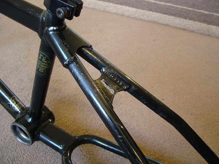

As you probably know i have a Black Loopy ripper with original finish... Do i strip it and repowder or leave it? Do i just strip the top of the rear tri where the marks are and touch it up to try and keep as much of the original finish as possible?

i would leave it as is.

the frame looks pretty good, leave the patina!!

i'd leave it too - survivors are the best
build up with other parts that have the same kinda aged look to them

As its in such a good original condition, id leave it  :)

strip it and refinish it. it's only paint. may as well make it look as minty as it deserves to.

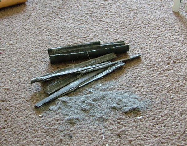

Good idea with the stem Jazzchimp... I have already sawn the post off though  :D
The seat post is out now :)   Zero damage  :D
Thanks all...i will post a pic in a few minutes  :)

The Piccys of the seat tube... and remnants of the naughty seatpost in question  :D
