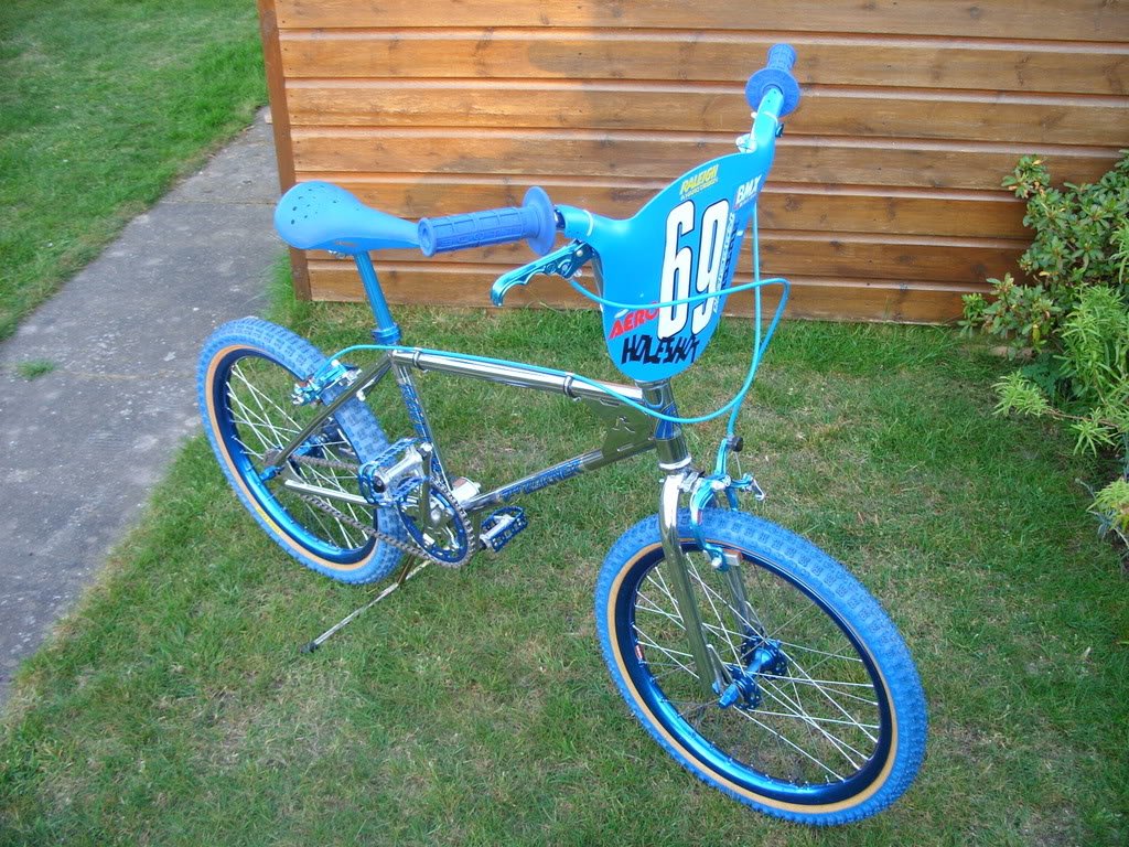

sorry to unearth an old thread and deck it out with a burner but got the wheels mounted today and wanted to give a big thanks to all who have given advice on this-

« Reply #14 on: April 28, 2007, 10:57 PM »
whhoooooo that is real nice, a reet minter that is,  :4_17_5:i wish i wasnt so tight then I could consider building myself something decent.
Have you still got the 184 spokes if so do you want to sell them, first dib dobs if so.

Nice. Lookin good.

Sweet looking wheels (even if they are on a burner)  :LolLolLolLol:
Did you go with 177's in the end? ???
stuey
Re: wheelbuild issue
« Reply #17 on: April 29, 2007, 08:29 AM »
Thanks for the kind comments guys, I did use 177's they worked a treat.
